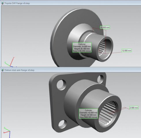

Speaking of which, any update if a smaller nut or something can be used for the Toyota flange?
#59 ArizonaZ
ArizonaZ
    HybridZ Supporter
  • Donating Members
  • PipPipPip
  • 59 posts
  • LocationTucson, Az
Posted 16 December 2016 - 10:23 AM
I got the new flange in the other day and started doing some math with it. The problem isn't the nut sticking out, but the end of the stub axle. If you want it to be flush with the companion flange face, then you can only take off about 2.5mm from the splined side. This leaves only 16.5mm of spline engagement vs the 24mm that the stock flange has.
