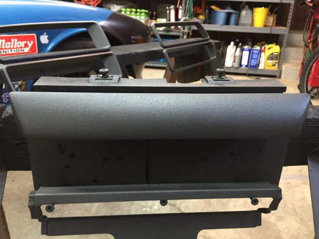

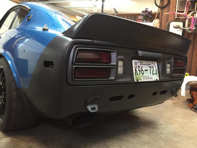

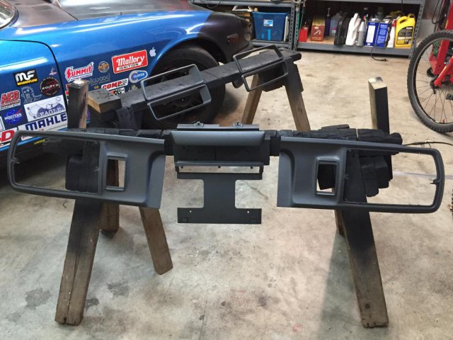

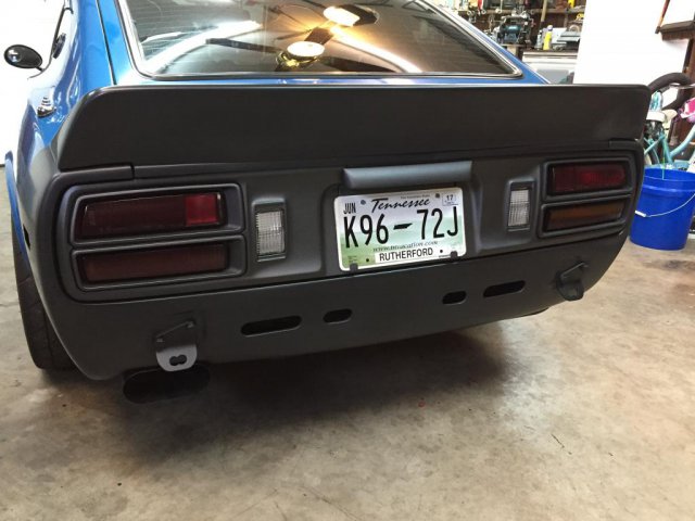

The products work great to restore our 40+ year old plastic pieces. The texture coating produces a nice look while hiding some of the imperfections and missing plastic chrome coating.
Sand smooth, plastic prep cleaner, plastic primer, SEM 39853 texture, then SEM 39033 color coat (charcoal metallic).
Works great.

Hmmmm, a lot of care has to be taken when using these sorts of finishes on the interior, there is a reason why all car makers keep texturing to a minimum. One problem is matching, all the interior should have the same sort of finish otherwise it looks bits and pieces and not coordinated. The other problem is the overall impression, it's easy to make some parts of the interior stand out from the rest in not a good way.
