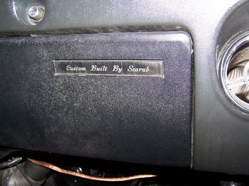

Yhea, that's definitely a fake, I have all the original sales brochures from scarab, those are definitely not scarab seats nor the scarab interior. And Im curious about those Valve covers I see on his and the ones you restored dsommer, the previous owner of mine swears the ones I have are original, and they are very close but subtly different to the style yours and his are. Mine have the same fluting and whatnot, but the Scarab name is on a raised peice of what feels kinda like plastic, its level with the top of the fluting. Did they make different styles, or who has the fakes :)
Anway, here are some pics, Ill get a closeup of the valve cover later.

The one on e-bay is not a fake!!!
There are 2 cars numbered #153.
It was a mistake on Scarab's part
Blue Scarab 153 build date 2/28/79
Red Scarab 153 build date 6/1x/79
White Scarab 154 build date 6/21/79 (mine)
I'm guessing the time lapse between the blue and red car (4 months) was sufficient time to lose paperwork/not check the proceeding cars Scarab number.
Again the car is real.
As the seller states though the engine and transmission have been replaced but are period correct. The radiator and fan are not original Scarab. I believe he does have the original Scarab valve covers (rare!).
