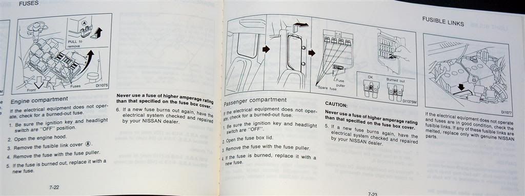

There is a fuse/relay box under the hood behind the driver's headlight, there is a small fuse box in front of the battery, and there is a fuse panel to the left of the gas pedal behind a kick panel. If the one you're looking for isn't one of those then I'm stumped.
  • Administrators
Okie Dokie. Here you go...
Just as 9kredline said;
Passenger compartment; drivers side kick panel, beside the clutch pedal.
Under the hood; BIG black box, can’t miss it.
The one next to the battery are the fusible links.
’93 owners Manual…
Under hood…
Kick panel…
Hope that helps…
