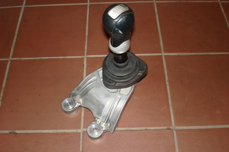

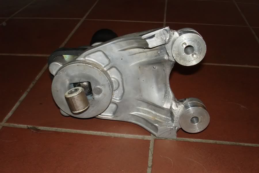

Alrighty i got some time in the machine shop this weekend and finished the shifter relocater. It turned out really nice and retains the factory 6th gear lockout. The mounting arms are kind of prototypes as they *should* put the bucket in the right place but will probably require some fine adjustment to get it perfect. The next set will have more meat around the tranny mounting points and will be radiused and c'bored.
Anyhow here is a picture of the sotck bracket and mine which moves the shifter forward a little over 4.1":

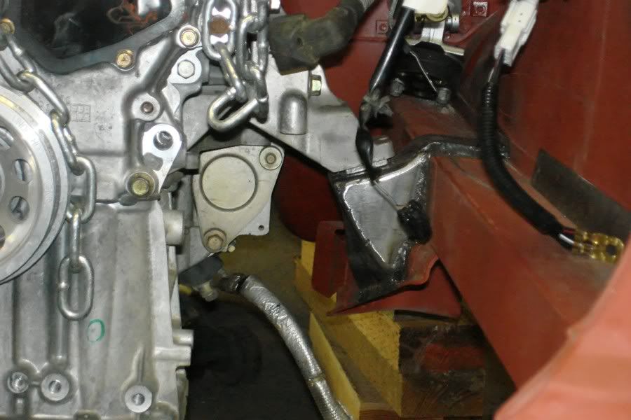

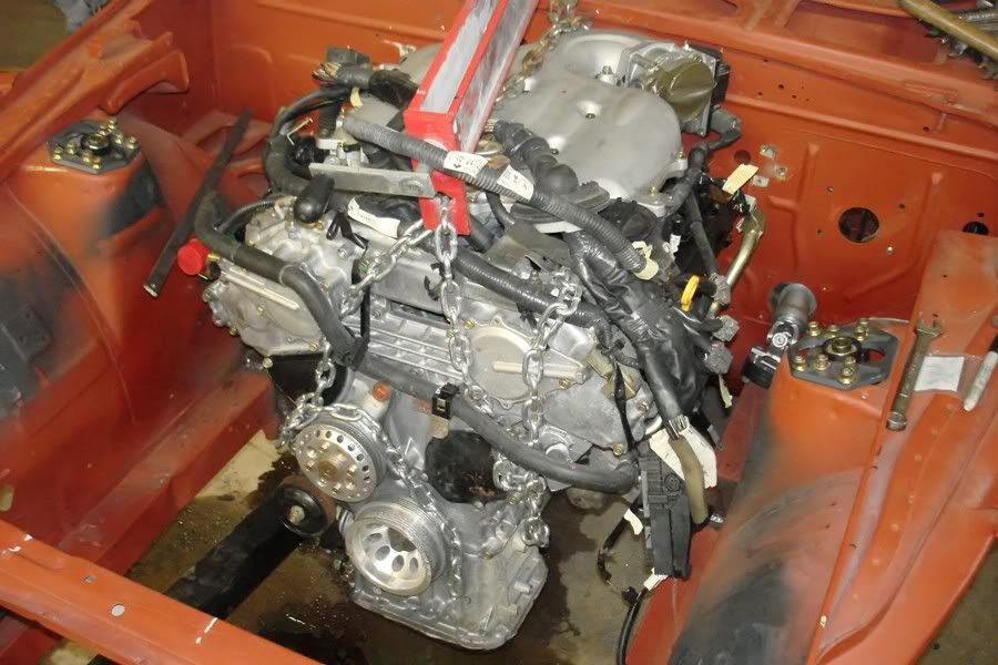

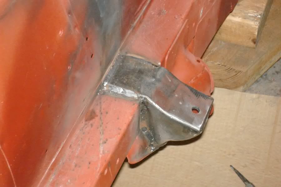

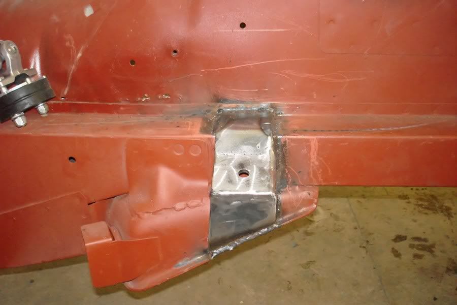

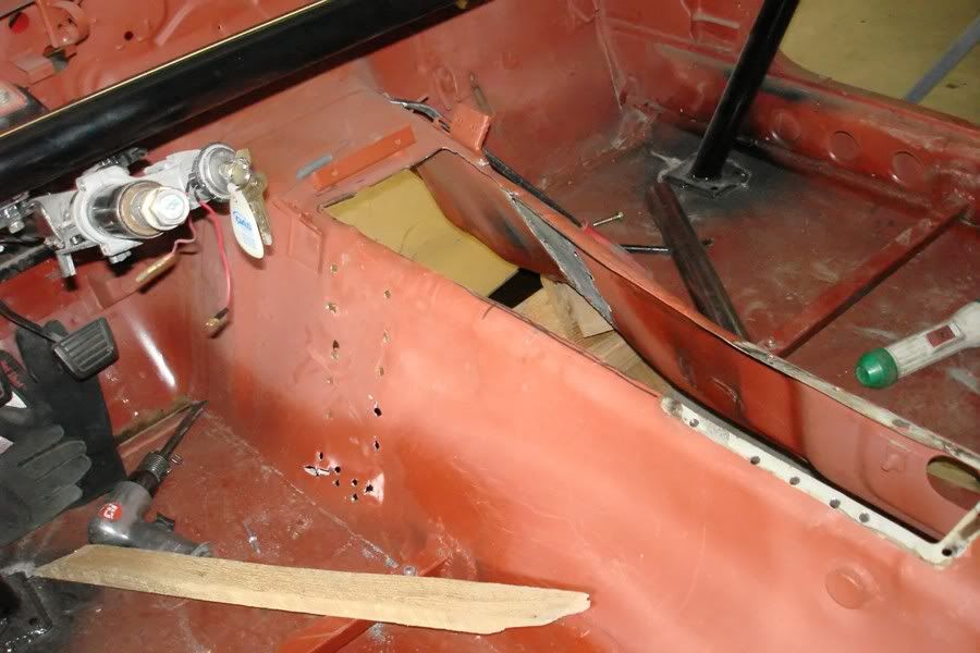

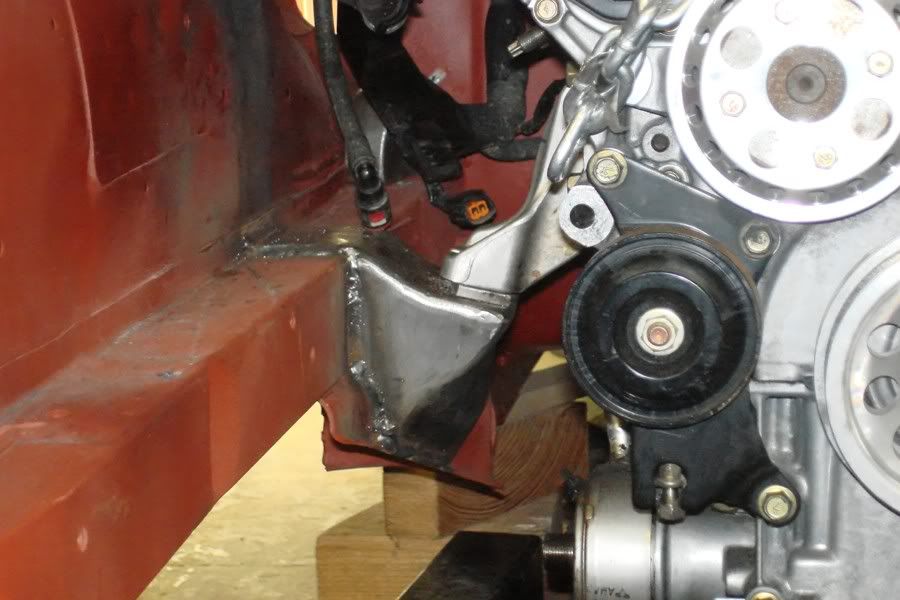

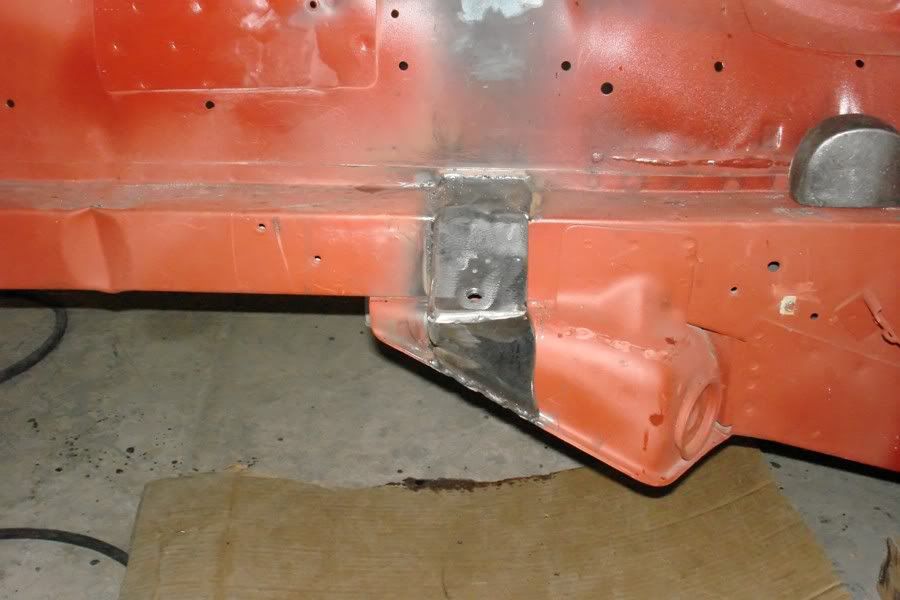

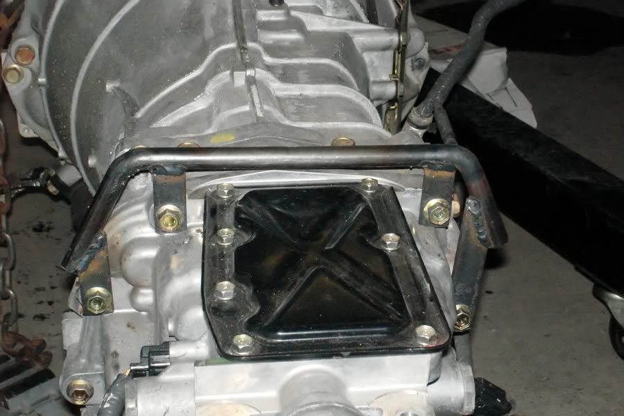

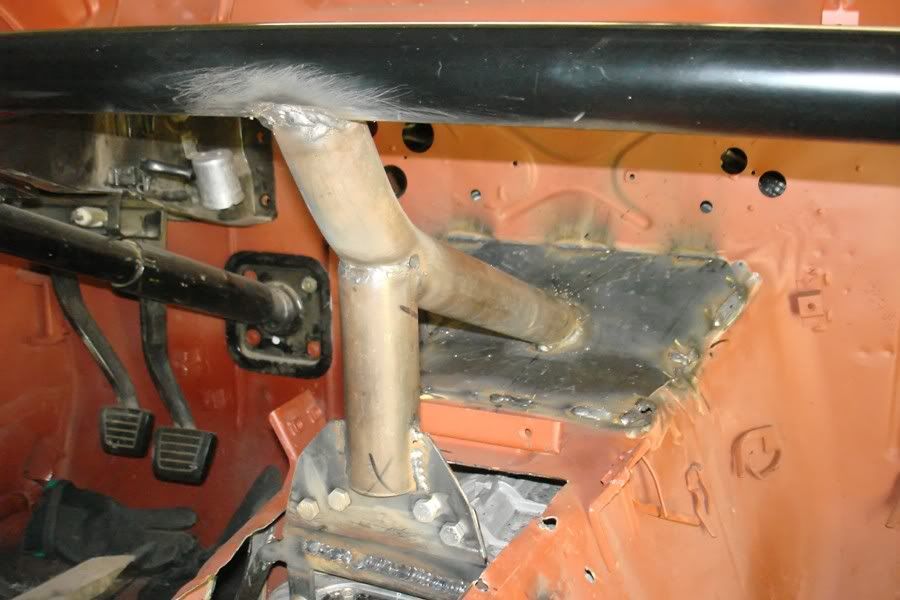

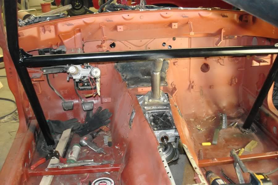

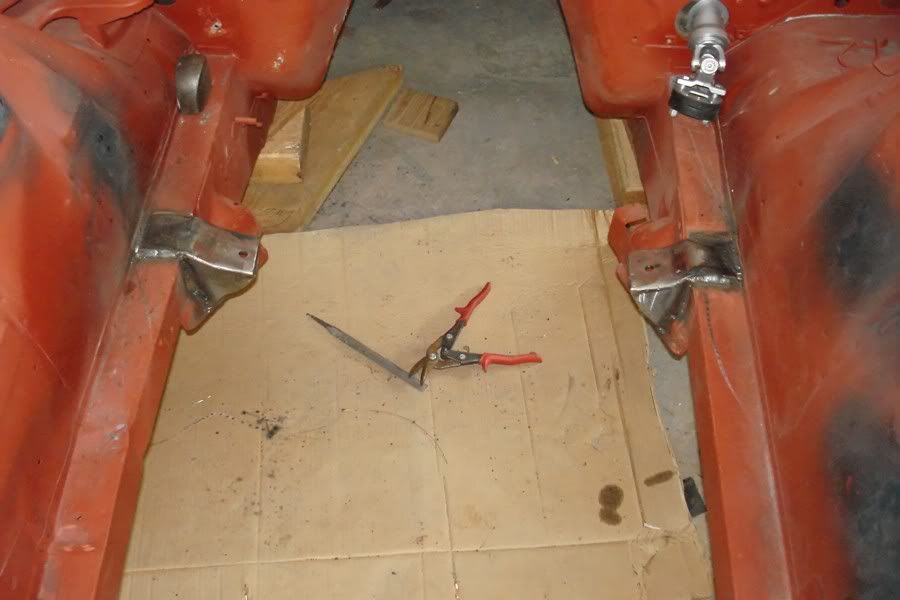

Since I have been using this thread as a guide for our VQ35 project, I thought I would upload some pictures of the progress. The engine and tranny are from a 2005 350Z which is going into a 1977 280Z. The car's focus is on the track application.
Posted Image
Posted Image
Posted Image
Posted Image
Posted Image
Posted Image
Posted Image
The engine is mounted with space for a 1/4-1/2 inch urethane spacer.
Posted Image
Posted Image
The crossmember has been boxed in on the back.
Posted Image

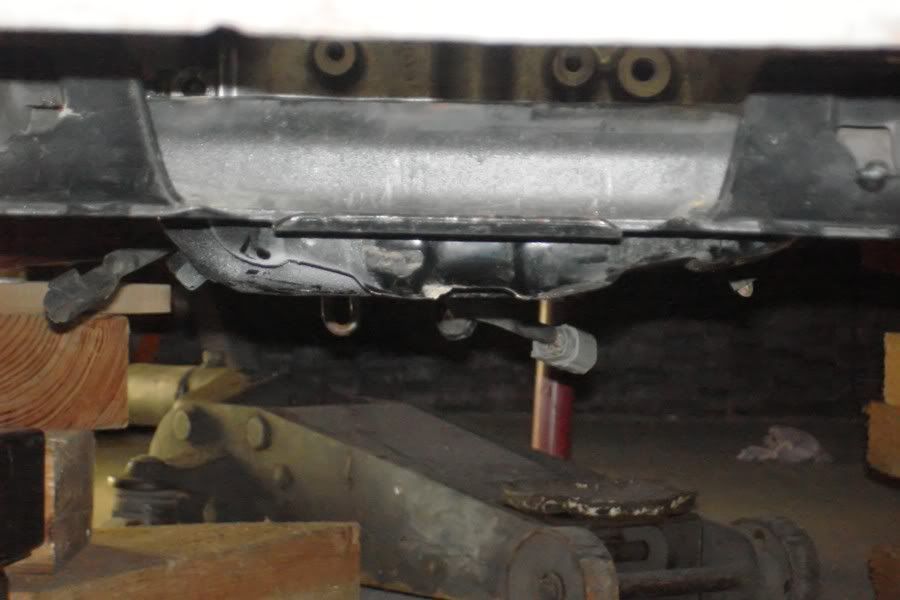

The oil pan is about an inch below the crossmember, and thus an inch closer to the ground than stock. Since this car has already been dropped about 3 inches, a skid plate will be fabricated to protect the oil pan.
Posted Image
Posted Image
Posted Image
Posted Image
Posted Image
Posted Image

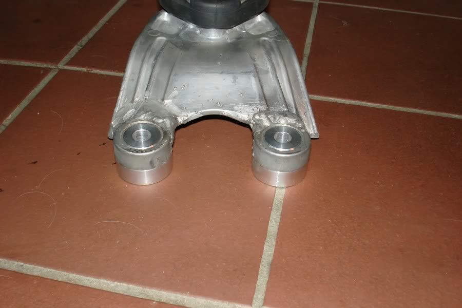

We chose to suspend the tranny mount from the roll bar. This gives us plenty of room for a duel exhaust system. I will get some pictures from under the car once it is put on the lift. Currently there is no front end.
Posted Image
Posted Image
Posted Image

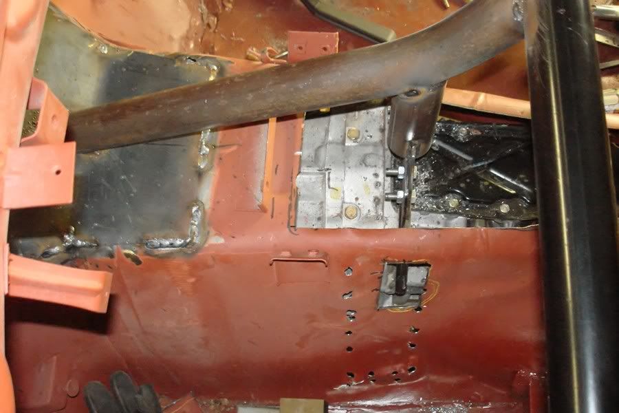

We used the same trick as Austin of cutting the shift linkage and welding the yokes together. Since the original shifter bracket was modified, a bushing needed to be fabricated to offset the loss of height from the original.
I will get some more pictures of the progress as I have time. The steering now works. The left hand engine mount interfered with the original geometry, so that shaft was cut and repositioned.
