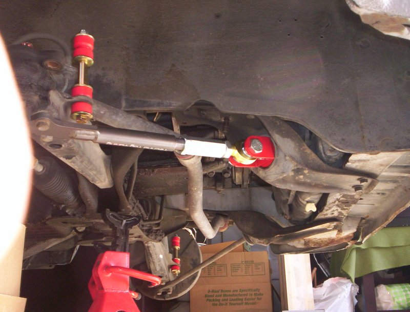

Tension rod and sway bar with new bushings installed:
Sway bar and tension rod installed:
Front tension rod and sway bar:
Uh-oh, that is a recipie for disaster! :confused2
You don't want two poly-bushings for T/C rods! You have to keep at least one OEM, or else there is a trick of drilling holes the the poly one.
Reason being is that most of the flex is now taken out of the bushing and transferred to the rod. Fatigue will ensue in a short time.
Otherwise, Awesome Job!! :icon14:

Thanks - you know I'd read about that before too - tales of TR's snapping (yikes!).
If I do swap back one of my OEM bushings....or just get a new OEM set and put on there...do you know which side to put it on (side facing the Tension rod, or side facing the front bumper)? Please say side facing front bumper.....I don't want to take that thing out again :)

Hi PhilbertZ,
From Guy 80LT1's S130 T/C rod build thread:
....John C. recomends using a conbo of rubber and poly with the poly on the same side as the nut.
Link to Dime Quarterly article about drilling the poly (thanks zcarnut): http://www.dimequarterly.tierranet.com/articles/tech_tcrod.html
-hughdogz
Thanks Hughdogz for the links - looks like I'll have to go back and swap in my old rubber on the back (non nut) side, or just get some new rubber and do that - I don't want to lose a tension rod...they are so hard to come across it seems.
Thanks guys!
