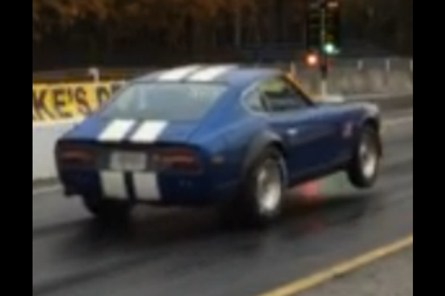

Popped my first little wheelie at the track yesterday! Mantic ER2 clutch, 3.54 gear, MT ETDrag 28x9 at 17psi, 4000 rpm on the 2-step. Having trouble posting pic and video taken on my buddy's phone. Looks awesome in the pic, but from the video, it just looks like I hit a little speed bump! Kinda like a little frog hop. But it was both front tires for sure! Had two other smaller wheelies on the five passes we made. Was in line with the 2-step turned up to 4500 and 15psi in the tires when the car in front of my left big pieces of engine and oil all over the track. It was gonna be a BIG clean up, so we got out of line and came on home. Car was not as fast on the 28s as on 26s. Not only was it dead-hooking off the line, it was bogging a bit on shifts. Either I'm down on power, or 3.54s and 28s plus tons of VHT on a perfectly prepped track is just too much for my modest 400hp. We walked the track before racing started-the surface was amazing.
