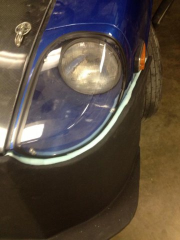

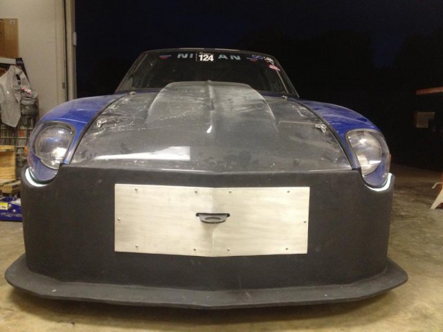

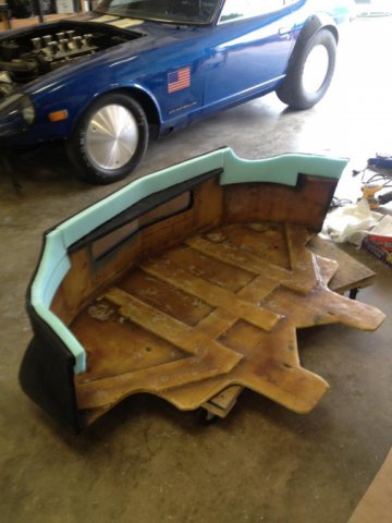

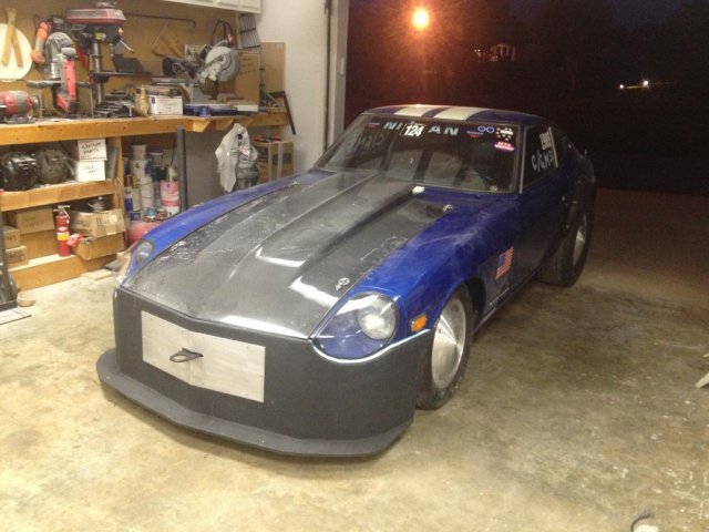

I published my race results and videos in the Gen3 sub forum of the V8 forum with a bunch of photos from the race. Car improved my class record from 167 to 174 due to the airdam and headlight covers and an unknown amount of help from a tail wind. I know that I put the car in a neglected class and that anybody who really wanted to work at it a little could go faster. But for the moment a hybridz with a totally stock LS2 engine is the ECTA C/GMS class record holder, destroying the previous record by 13mph. My goal for next year is to go the same speed with my hands lightly on the wheel with relaxed hands instead of being white-knuckled and scared to death. That's gonna take some suspension setup revisions. If i can get the car to go straighter, i will have to consider whether i want to try to take this car faster, or to build a real race car dedicated to straight line racing. Next stop is ZCON Memphis, Jily 15-18, to participate in all 3 driving events and the show.
