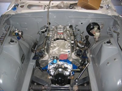

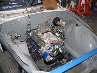

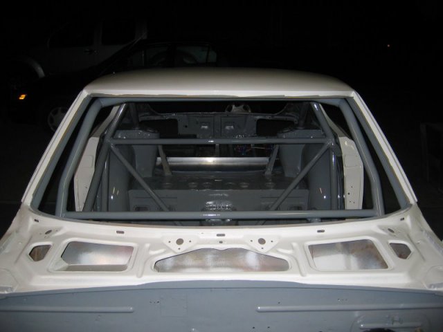

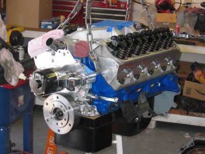

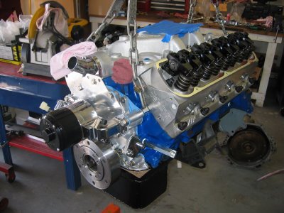

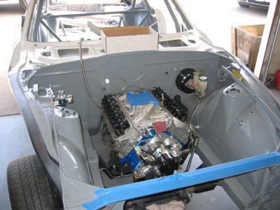

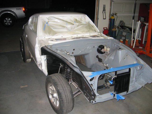

	Got the motor trans in today and interior painted the other day. Had to rework the steering after we installed the motor with the headers, but it all worked out. Coming up next week we will start the wiring and alternator mount, should be fun. Here are some pics of our progress, enjoy.

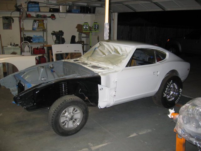

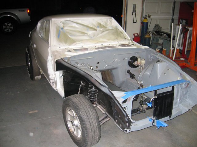

	OK guys here is the latest progress on our project. Well we got the body work as good as it was going to get and put up a temporary spray booth in my garage to shoot some color on the car. Turned out OK, we were going for the 50/50 look so as long as the car is moving or your 50 feet away it looks pretty darn good! Now we can get back to the fun stuff, putting it back together and getting it running. Here are some photos I this last weekend, enjoy.

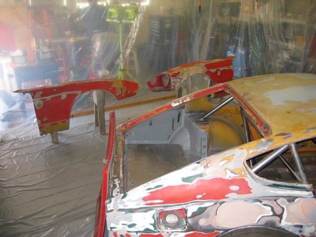

	Well we have been hot and heavy on the body work but as of late life has been keeping us away from the project a bit. No new pics for now but as soon as I get the 1/2" of sanding dust cleaned off of everything I will take some more. We are getting close, as soon as we get the car painted we will make the big push to get it running! (I can't wait to hear that motor sing man!). Well thats all for now.

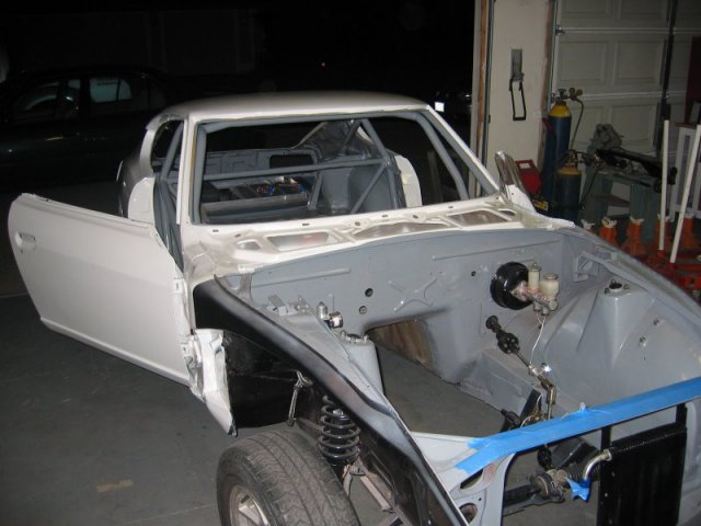

	That was our thoughts exactly! I got the idea from a NASCAR race I went to and the engine bay was grey, though it looks clean so off to the home center for some grey Rustolium. The firewall actually did not need to be cut for motor clearance, there was some rust in the fender well under the battery tray that ended up taking out a 18' section of the firewall. We just started the bodywork, we decided to fabricate a new rear roll pan because ours was soooooooo bad. I will post some more pics soon.
	Thanks man, we have been working our tails off on this thing. Even though it is going to be a track only car, I still want it to look good. As for the cross member, we built it ourselves. We were heavily influenced by some of the other SBF projects though. We just hung the motor in the hole and started cutting and fitting until we had a cross member. Took a couple hours. I will have some more photos in a few.

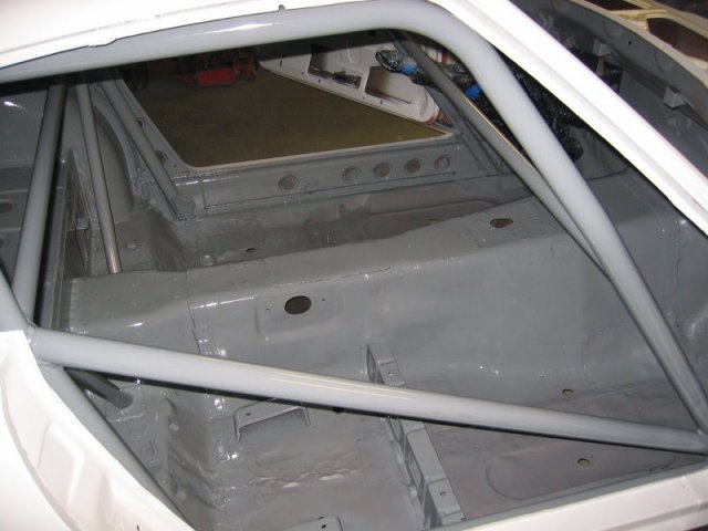

	Hatch floor question . Cutting it for a fuel celler34gtt2000jp replied to gretchen/jason's topic in Fabrication / Welding Here is what we did on my drag car project. Basically I cut out the entire floor between the frame rails in the hatch floor. I cut from the cross member between the shock towers back to the cross member under the tail lights. Then I took 1" X 1" square tubing and made a frame for my battery box and fuel cell. This also serves as the mounting area for the flue pump and filter. Currently we are working on a "dog house" to cover it all that will have the top open on a hinge. This was all without cutting any frame members. For reference the aluminum "dog house" is 17" x 34" and we are using a 5 gallon fuel cell the is about 13" x 13" x 8" Here are some photos. Hope this helps.
