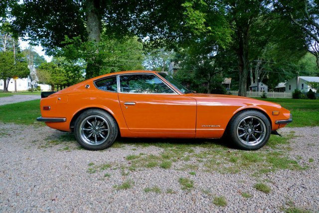

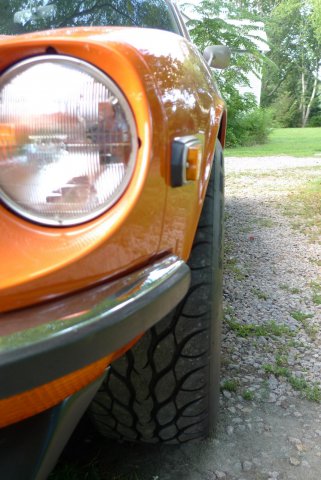

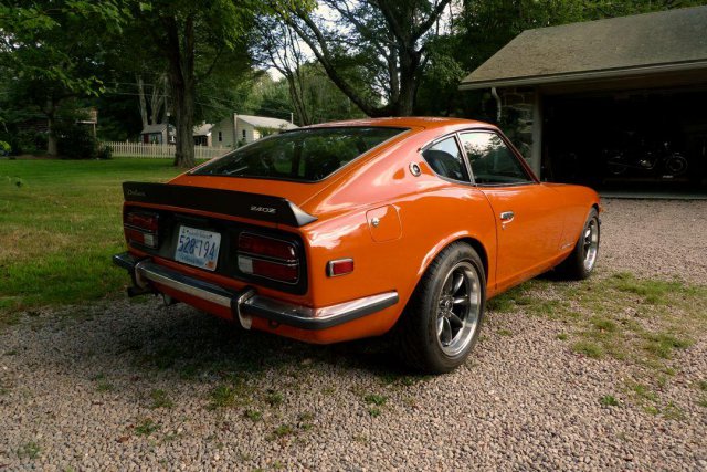

Rob240z replied to 415DZ's topic in Brakes, Wheels, Suspension and Chassis
I'm running 16x8 Rota RBR with 225/50/16. They are +10 offset with 8mm wheel spacers on all for 4. I had to trim the lip on the rear about 1/4 inch. The inside of the rears have about 1/8-3/16" clearance from tire to spring. On the front I had to trim just the lower front portion of the wheel well so it wouldn't hit while turning. I have the stock front valance with a BRE spook. If you were running an air dam like the MSA type I the front wouldn't need trimming. If the rims were available in +04 offset when I bought them that would have been my choice because you wouldn't need spacers. I'm running BFG KDW2's. All tires are a little different in dimension even if the are the same exact advertised size. It's less about what size rim fits, and more about the tires size when it's mounted on a particular rim. I don't like it myself, but a undersized tire stretched to fit an 8" wide rim could easily fit without any trimming. My suspension is Eibach lowering springs on KYB struts. It sits about 1 1/2" lower than stock. I had to cut 1 coil from the progressive front springs to remove the nose up look. The top 4 coils were completely compressed when sitting still so it didn't have any effect on the effective spring rate. Rob -

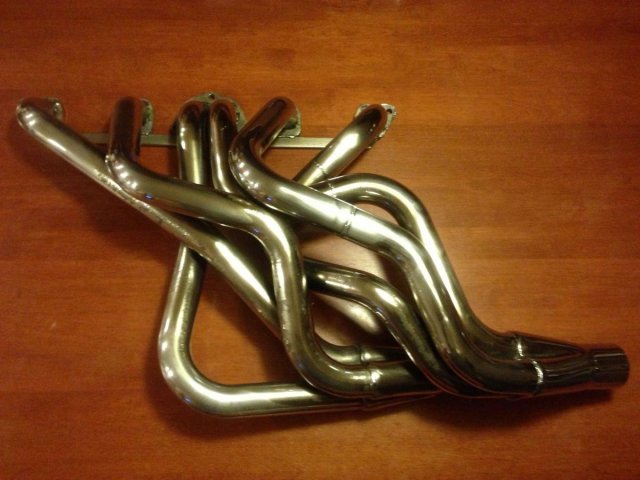

I finally found one. Someone on here contacted me because of this ad. They had one that had never been run before (just trial fitted) that has a little rust and some of the chrome peeling. I scrubbed it with some oxalic acid to remove the rust and polished it with mothers. I think it came out really good. I had bought the pacesetter header off ebay, but the build quality of this is so much better. The pace setter ports had welds that were very inconsistent and very large. The welds made the ports significantly smaller than the inside pipe diameter. When I made a port template of my rebello ported p90, the Nissan Motorsport header matched the ports almost perfectly. The header ports are just slightly larger than the head, which is perfect in my mind. I'm very happy with this header. Now Just need to get it fitted when the motor goes in then it's off to Swain Tech for their white lightning coating. This header was really hard to find so I want to make sure it lasts as long as possible.

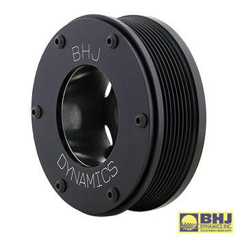

How often would you say a supercharger eats a belt? I was thinking I might have some belt slippage to deal with. I didn't consider that I would be going through belts very often. If that is something that happens frequently maybe keeping the supercharger on a seperate belt would be the smarter thing to do. BHJ makes a v-groove pulley that bolts to the front of the crank pulley. I could use that to spin the water pump and alternator. I was hoping to use it to spin an AC compressor if I decided to install AC at some point in the future though. What do you think of MSA electronic water pump?

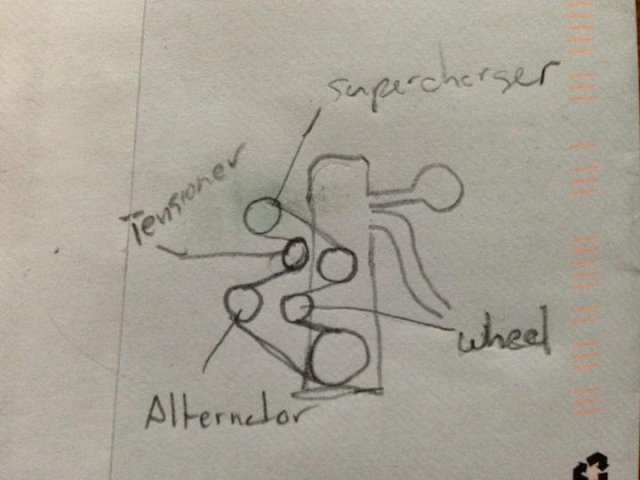

I didn't realize you were using a manual tensioner. I couldn't see the back of it and thought you were maybe using some kind of spring or something else to make it into an automatic tensioner assembly. Yes about alternator being high. My drawing was very rough. The crank and water pump pulleys are drawn much farther apart than in reality too. I think a good wrap can be achieved by placing a idler pulley in between and to the left of the crank and water pump pulleys as long as the top of the idler pulley is above the bottom of the water pump pulley and the bottom is below the top of the crank pulley. The size of the idler can be increased to get more wrap. I'll explain my thought process even if it's flawed as to why I decided to go with an 8 rib serpentine conversion on my engine build: The supercharger comes with and uses an 8 rib pulley. I have always planned to use an automatic tensioner as every other centrifugal install I've seen incorporates one into the supercharger bracket and I just assumed there was a good reason every serpentine belt system I've seen does. I was planning on upgrading my original 240 alternator to one with more amps so I figured why not just get one that has an 8 rib pulley on it anyway. My work van has a 100 amp alternator with an 8 rib pulley that seems like it would work fine. Since I already have to make a supercharger bracket, I figured why not make it to hold the alternator too. That way I can position it where I like. I wanted to run a quality damper and was looking on BHJ website and noticed they make an 8 rib damper that lines up exactly where the original crank pulley does. So I bought it. The only thing left is the water pump pulley conversion which shouldn't be to hard. Originally I was going to buy the electric water pump from MSA, but I have been seeing conflicting reviews about it and have decided not to take the risk. It seemed like converting everything to 8 rib serpentine was the right choice. But after seeing your setup, it probably would have been easier to add an 8 rib pulley to the end of the crank pulley and run the supercharger on a separate belt system. Making the supercharger bracket would have been easier. But I have already purchased the the BHJ damper, and it wasn't cheap, so I think I should continue as planned. The other benefit is the clearance to the radiator and electric fans isn't a problem with this setup. I am a little worried though that the high tension from the serpentine system will be to much for the water pump shaft. Do you think the water pump can handle it? This is a picture of the BHJ damper I bought if you haven't seen it before. http://www.bhjdynamics.com/index.php?main_page=product_info&cPath=10&products_id=238

This is a very rough sketch looking at the front of the engine. My plan was to make a plate style bracket that holds the supercharger, alternator, tensioner, and extra wheel all in line with each other.
Hi Xnke, I'm following this thread with great interest. What you've done so far looks great and has given me some ideas on my current build. I'm currently trying to figure out how I'm going to run a serpentine belt on my setup. After seeing how you have set up your pulley/tensioner I think I'm going to route mine similar to you. I've never seen a sliding tensioner like your doing. How does it work? All the tensioners I've seen swing in an arch. My build is a little different, but there is a lot of similarities. The biggest difference is I'm using a rotrex c81 supercharger, but locating it in almost the same position you are. I bought a BHJ damper that has an 8-rib pulley attached to it instead of the v-belt pulley. I'm using an 8-rib alternator so I can line all the assessories up. I think this will give me a little space to the radiator and fans. On your posts about estimating the horsepower your set up will make, my best guess is that you are being conservative. Corky Bell wrote a great book called "Supercharged! Design, Testing and Installation of Supercharger Systems". When I was planning my supercharger build I created a spreadsheet that used all the relavent equations from his book. I followed his workflow on designing my supercharger system in how it was applicable to what I was trying to achieve. There's a lot of good advice in his book, especially on avoiding detonation, which was my biggest concern. I'm not expecting my actual power numbers to come out exactly as calculated, but it at least was something to use that wasn't a blind guess and should get me in the ballpark. If you want the spreadsheet to play around with I'd be glad to send it to you. Keep up the excellent work. I'm looking forward to watching this build and seeing the final outcome too. Rob
