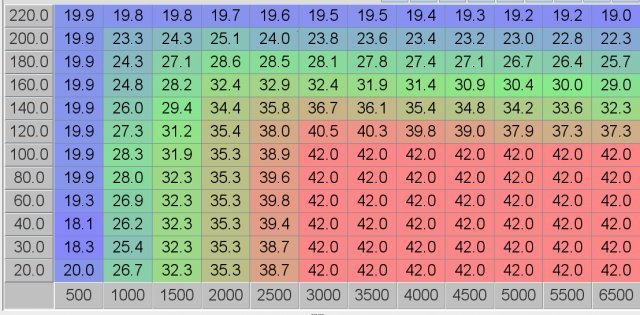

Ignore anything past 150kPa or 4500RPM - untuned areas. Plugged in raw numbers from a borrowed map. -

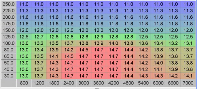

I tuned the map a little and am now showing 12.0:1 AFR at WOT and 150kPa (7psi boost). But it still acts like it's flat, and I'm willing to be that the plug tips look white. I'll try running Dave's AFR map and using his VE as a starting point, and see if I can't get those plug tips to a nice tan color. -

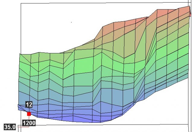

I am attaching my ignition and AFR maps. Also note that my VE map looks awfully flat (the areas above 100kPa and 4000RPM aren't tuned, so ignore those areas). *EDIT* Is it possible that I have something incorrectly wired on the Megasquirt board? I have a good tach signal and the advance seems to be moving as commanded by Megasquirt, so everything seems okay. But maybe I'm missing something... -
