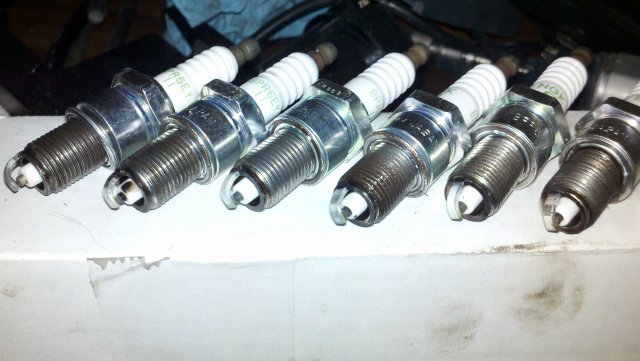

Ok, put in a fresh set of BPR6EY-11 plugs, gapped to .030. I moved the #4 plug wire to #6 and moved the #4 injector to #1. Took it for a 20-minute test drive and pulled the plugs. Now all six look lean. #2 also looks like it has a burn mark, but I think that is from a spot of copper anti-seize that made it onto the insulator during installation. None of the electrodes had a wet appearance. My Supra MkIII turbo injectors are port-injecting into a stock 280zx turbo manifold, so I don't think there's a problem with the spray pattern itself. Fuel is supplied by a Walbro GSL392 inline pump, pushing fuel through the stock hardline and up to a -8AN braided stainless line in the engine bay, on to a Pallnet rail, and regulated by an Aeromotive FPR with a mechanical pressure gauge. Return feeds into stock return hardline. Reading 45psi fuel pressure at idle. My AFRs still look dead on. I get intermittent intake backfiring at full throttle, but my WBO2 shows 13-14:1. It still feels flat through the power band, but idles great and pulls fairly well under light throttle. I parked the car and hooked up a cheap timing gun. The white dot I painted on the crank wheel definitely advances when I hand-throttle the engine, so at least some sort of advance is being commanded. But maybe at higher RPMs I'm getting signal noise and the SAW signal is dropping out? I think if the SAW weren't commanding advance at idle, I'd be in limp-home mode and only seeing 10*BTDC. But I'm not sure how I could be getting interference on the SAW wire, as the EDIS module and the Megasquirt relay board are only 6" apart inside the glove box, and I don't recall seeing any high current wires passing near them. Fuel pressure looks good when the car's parked and I hand-rev the engine, but maybe it's dropping out under load...? Need to figure out a way to read mechanical fuel pressure while driving. Other thoughts? What's going on here? My 0-60 time is something like 7-8 seconds. Even for a daily driver, that is unacceptable! -

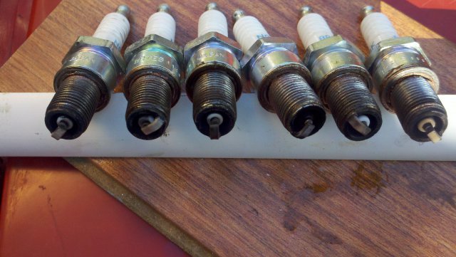

I finally have my 1976 280z with a freshly rebuilt L28ET swap up and running. It drives okay under low load, but I feel like it is at only 50% power. Under 7psi boost and/or WOT, I am getting intake backfires. My wideband O2 sensor is showing healthy AFRs under all operating conditions. Compression check shows 135-145psi across all six cylinders. I pulled the spark plugs and observed whitish firing ends on five out of six plugs. However, plug #4 definitely looked darker and fouled. These plugs all have less than 500 miles on them. I've looked at several spark plug diagnosis charts, and it definitely looks like a classic fouled plug to me. But I'd love to hear what you guys have to say!
After the test drive, I still thought the car felt weak. So I rechecked the compression, calibrated the LC-1, and checked the spark plugs. I noticed something interesting with the plugs - it looks like 5 out of 6 plugs looked whitish (lean), and cylinder #4's spark plug looked very dark (rich!). I think that injector #4 may be sticking open, leading to overfueling in that cylinder. But the net exhaust output looks stoichometric to the LC-1, so I wasn't seeing anything in the logs. I will have the injectors cleaned and tested this week, reinstall, and see what happens. Getting closer!
