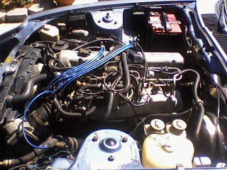

  10. okay so i finally figured out what it was ... my air regulator was the thing that was causing me all those problems ... were can i find a after market fuel rail for my l28?
  11. thanks man ill check out the BCCD in the morning and as for the cold start its all in the trash now i just need to cut out plates to seal the holes but what you are describing about the BDDC sounds like what going on with my car the noise im hearing is not a vacuum leak it sounds more like something is spraying somewhere around the intake manifold but can really tell where and i just replaced all my injectors today so its not that but like i said ill get back to you after i check out the BCCD sounds like thats the problem thanks again the nois sounds like a vvvrrrrrrrrrrrrrrrrrr when its hanging at 2000 back down to idle but other then that car runs great
  12. how much resistence should the cold start injector have mine shows 5 ohms and the rest of my injectors are between 2.7 - 3 ohms i took everything apart today and still doing the same thing i checked all my connections too...
  13. iv tried that it still makes the noise it runs good and everything just the rpms drop down slow from 2000-idle ive been trying to figure it out for the last couple days dont know what it is

  15. okay my car just started doing something weird that it never used to do if i rev it up when it comes back down and hits 2000 rpm it starts makeing a weird noise like if the cold start injector is shoting alot of fuel into the manifold iv had this car for a year and it has never done that it does it starting from 2000 rpm and stops when it gets back to idle the rpms just go down real slow has anyone had this problem before??? its a 1980 280zx
