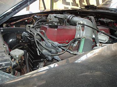

few shots of the engine bay of my 240Z fitted with an RB30 turbo out of an australian holden vl turbo commodore(nissan engine) currently running 5 speed,T3(14psi),3.36:1 R180,bar and plate fmic,wolf 3D ems......soon fitting 3.54:1 R200 lsd,ported head,bigger cam,custom plenum and ex manifold(extractor type),R34 tube/fin fmic,550cc injectors,strengthened jatco auto and 2800 rpm hi stall,and of course bigger turbo(GT35R or GT3076R...not decided yet)

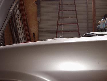

..........i beleive the 94/95 cobra intake is a low version as well,from my measurements it seems it should fit in my engine bay and clear the hood(see pic) i have 9" to the top of the air filter element.....the same height as the above mentioned intake from what i have been told....measured from the top of the block near where the distributor goes that's the good news......the bad news is these particular intakes seem to fetch an arm and a leg on ebay,unlike the explorer or 86-93 cobra intakes(more than a used performer,holley,gt40 at around US$360+) and are not commonly listed i am considering just using the HO 5.0 94/5 intake either as is or sending it to tom moss for porting read my thread on turbomustang.com......sorry guys had to go to the dark side as my post on hybridz didn't give me the info i needed,lol http://www.turbomustangs.com/smf/index.php?topic=71823.0 regards paul
try this guy ,AU$800,good luck.....link above
can't beleive no-one has an answer to this one,it's hardly out in left field,efi 302 in a Z?
done a search but nothing conclusive will an explorer intake fit under the hood of a Z with a 302 in it? i believe the standard HO mustang intake is around 9" tall and the explorer (gt40) is about 10 3/4" has anyone got a gt40/explorer intake to clear the hood?? is it possible to mill some off the explorer one to lower it some?? is it worth the messing around or just better to use the standard mustang 5.0 one?? i intend using it in a turbo application cheers guys paul WA

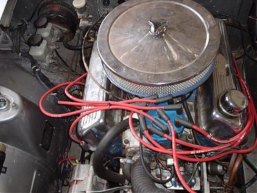

Greetings from downunder Just about finished collecting parts for the turbo conversion of a 302 windsor in my "z" motor is not standard(alloy heads,roller cam/rockers,o-ringed block,forged pistons 8.5:1,crank girdle)and looking for 500-550HP looking for suggestions re turbo size,i've done a search and most guys are using PT76 turbos....i was wondering about either a garrett GT35/82r or a TO4Z with a .84 turbine housing which turbine size for rapid/low rev spool-up(have 50mm wastegate)?? what difference in spool-up am i likely to notice going to a dual ball bearing rather than plain bearing turbo?? i will be running an auto(have 5 speed atm) looking for good low rev torque/spool-up as long as i will be able to get traction(running 3.54:1 quaife 'lsd' diff with 15"x215 60 series tires,std suspension) thanks guys
