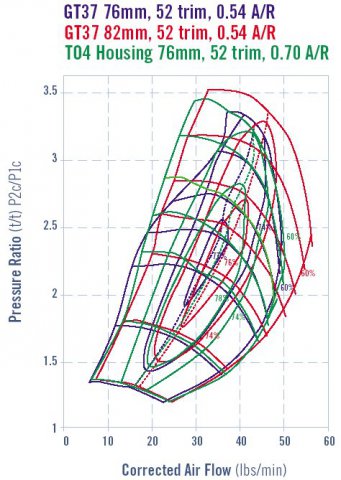

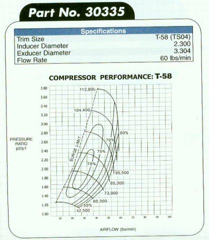

  11. Will this turbo do what I want? hi guys looking for opinions as to the suitability of this turbo for my 302 240Z..... forged 8.5:1 pistons,eagle rods,edelbrock performer heads,roller cam/rockers,have performer intake with injectors as well as tuneable engine management system but am contemplating going staight propane instead(have twin GRA gas carbies and twin B2 converters) really want to minimize lag and keep boost threshold low(revs) so wonder if the turbine A/R is too large(1.11),was considering using half the tangential inlet(ie 1.11 divided by 2) and running a 50mm external wastegate through a muffler to atmosphere(hoping to keep back pressure/heat down in the valve/heads)would love to be able to switch the wastegated gas thru the second half of the tangential housing at higher revs like a variable turbine....anyone have any thoughts on this?? compressor is supposed to be good for 55lbs/min or roughly 550hp which is about all i'd want to put a 302 block thru feel free to give your opinion and experience oh and forgot to mention i plan running an auto and 2800rpm stall converter GT3782 .58A/R TS04 compressor cover with 4" inlet 59mm inducer 82mm Major 1.11A/R T4 turbine housing 66.5mm exducer 72.5mm Major Full floating oil cooled CHRA 3" V-band outlet thanks guys paul western australia
  12. hi guys looking for opinions as to the suitability of this turbo for my 302 240Z..... forged 8.5:1 pistons,eagle rods,edelbrock performer heads,roller cam/rockers,have performer intake with injectors as well as tuneable engine management system but am contemplating going staight propane instead(have twin GRA gas carbies and twin B2 converters) really want to minimize lag and keep boost threshold low(revs) so wonder if the turbine A/R is too large(1.11),was considering using half the tangential inlet(ie 1.11 divided by 2) and running a 50mm external wastegate through a muffler to atmosphere(hoping to keep back pressure/heat down in the valve/heads)would love to be able to switch the wastegated gas thru the second half of the tangential housing at higher revs like a variable turbine....anyone have any thoughts on this?? compressor is supposed to be good for 55lbs/min or roughly 550hp which is about all i'd want to put a 302 block thru feel free to give your opinion and experience oh and forgot to mention i plan running an auto and 2800rpm stall converter GT3782 .58A/R TS04 compressor cover with 4" inlet 59mm inducer 82mm Major 1.11A/R T4 turbine housing 66.5mm exducer 72.5mm Major Full floating oil cooled CHRA 3" V-band outlet thanks guys paul western australia
  13. does this mean that the twin turbos will boost earlier(more responsive) in the rev range but run out of puff higher up the rpm scale? thanks to you all you guys who contributed paul
