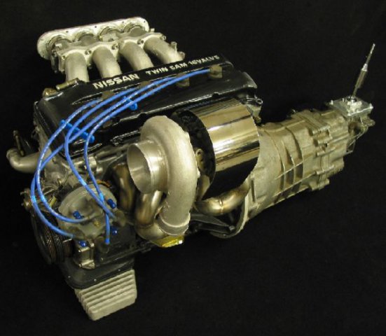

Ok, so I've recently acquired my dream car since the 7th grade... A 72' S30 and would like to place in my KA24DE-T. I've been considering the substitution of my current KA/SR trans. for the stouter Z32 trans. I already have a Z32 R200 diff as well and would like to be able to utilize both components in my motor/trans swap... My most important question i believe would be, what size of driveshaft would be required? Has anyone one else performed this swap i.e. Z32 trans and diff swap? I've been searching around for sometime now to no avail and so I've decided to simply post up and ask for help... Thank you in advance, for any and all the help you can give me. Here's a picture of a built KA with Z32 trans attached...
Its a g nose, alot of difernt companies make these conversions still.
