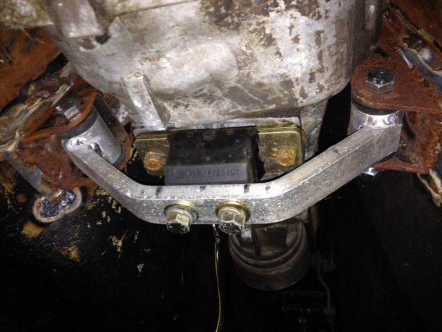

Here is the Al trans mount. I moved the OE brackets back and used a urethane mount to make it cheaper and easier to replace. I also took pics of the distance between the engine and fire wall for my own knowledge.

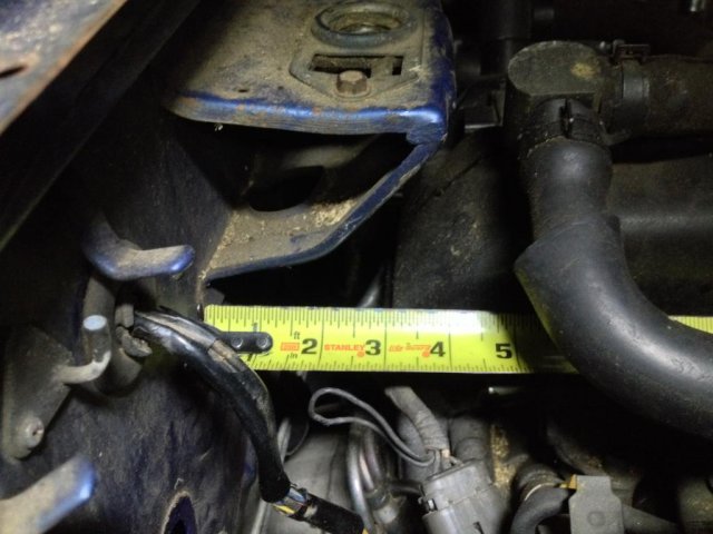

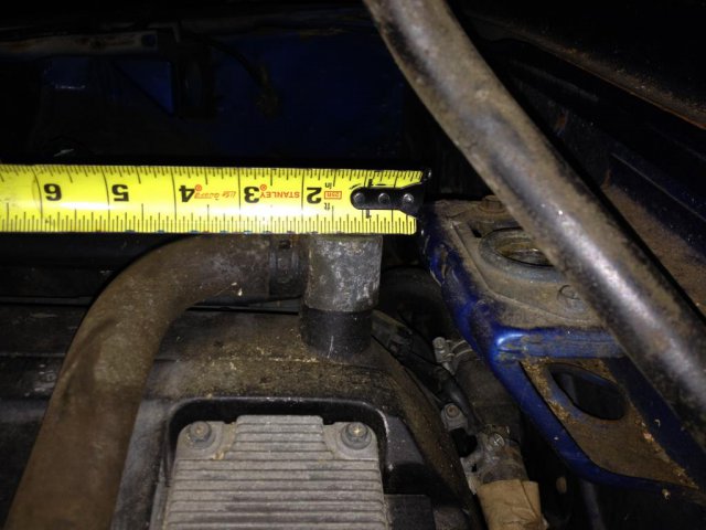

Hoover, The engine may not be an inch, but i'll have to measure it when i get a chance. It is close enough that the valve cover breathers scratched the crap out of the hood latch down there at the back of the engine. I fabbed up my own Al tranny mount. It wasn't hard...just time consuming. I'll see if i can get a pic of the tranny mount if you want. I attached the "apparently" only pic I have of the engine mounts (only 1 side). They are very nice. EZ

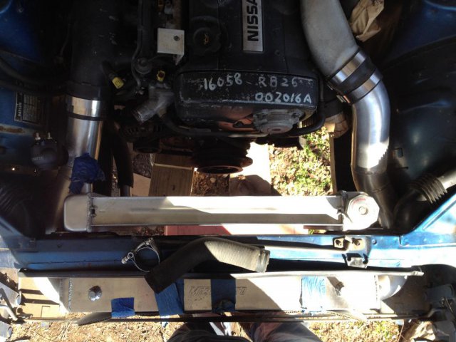

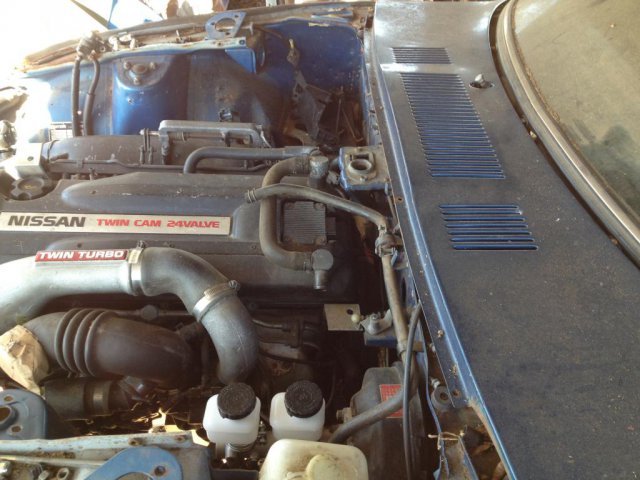

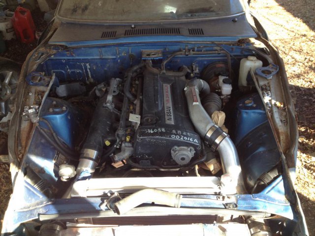

I like the way the engine is placed with Ricks mounts. I have attached pics. Please excuse the dirty engine bay. I'm still in the middle of the build and a shed/shade tree mechanic.
