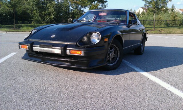

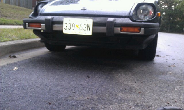

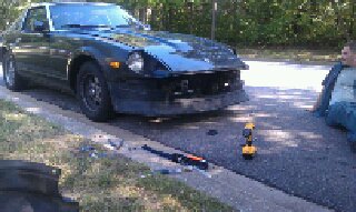

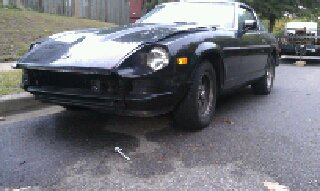

Just got the new front air dam installed figured I would put a few pictures up of how everything went. From stock Bumper off Test fit Paint, I also did the black parts of the bumper at this point too but it wasn't a new piece so no picture hahaha And.... Done Why not throw in a cool little parking lot picture for the fun of it. Doesn't look to bad if I do say so myself. I might end up throwing some of that chrome mesh stuff in to fill the gap in the bumper and air dam/ to prevent rocks from flying up in there, but we will see.
