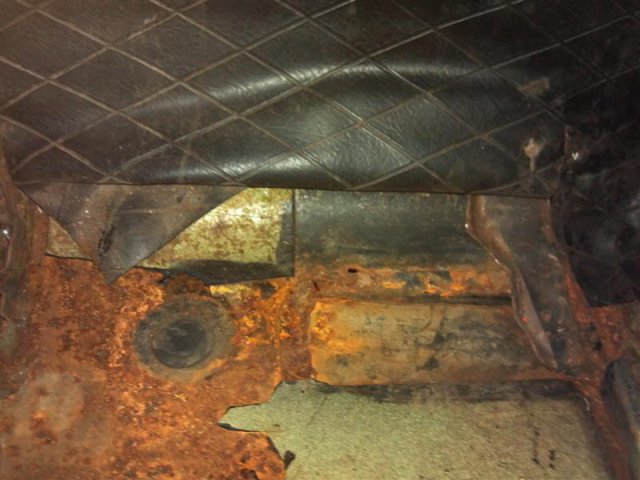

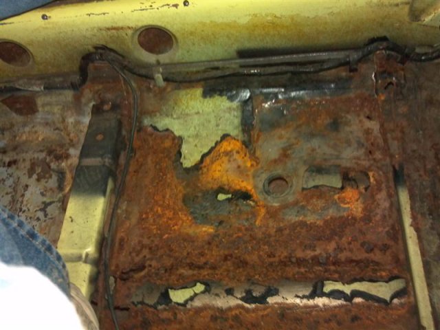

I'm going to pick up some steel so I can dig in to the TC box repairs and see what else is there. What is the recommended size steel for this? I know I need to do a two layer repair but am not sure of how thick the steel should be. I'd rather get a whole sheet and have a bunch left over so I don't have to make multiple trips to the steel distributor. -

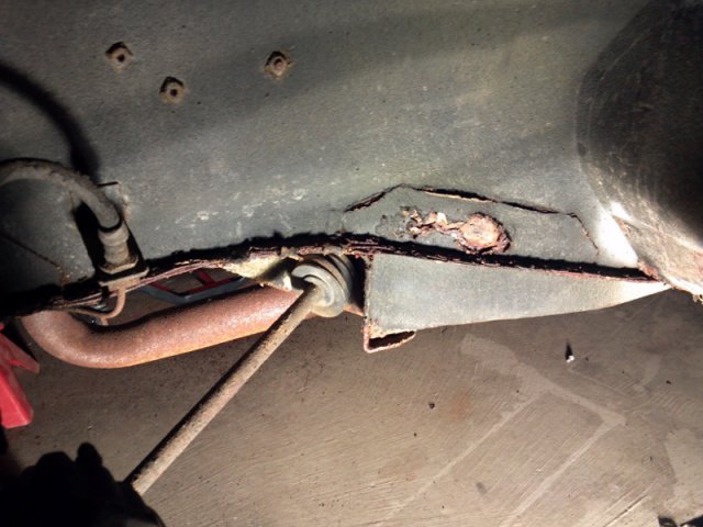

The rest of the car isn't bad. There isn't all that much rust-through on the floors but I am planning on doing it right while I have it apart... Zedd Findings floor pans are on the way. I had already ordered the Bad Dog frame rails. I've attached a pic of another area that needs attention in the front fender well. What is this area called? I remember seeing a thread where someone described fixing this exact area and fabbing up everything; it was very descriptive with pics. I don't know the search terms for this though. Any idea? -

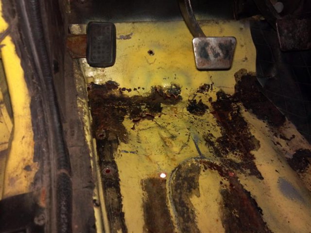

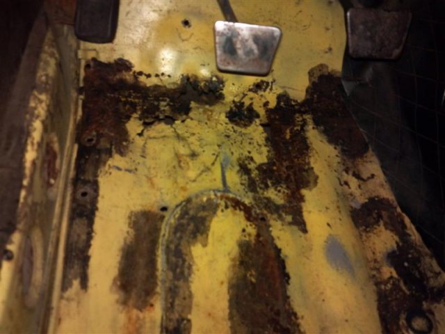

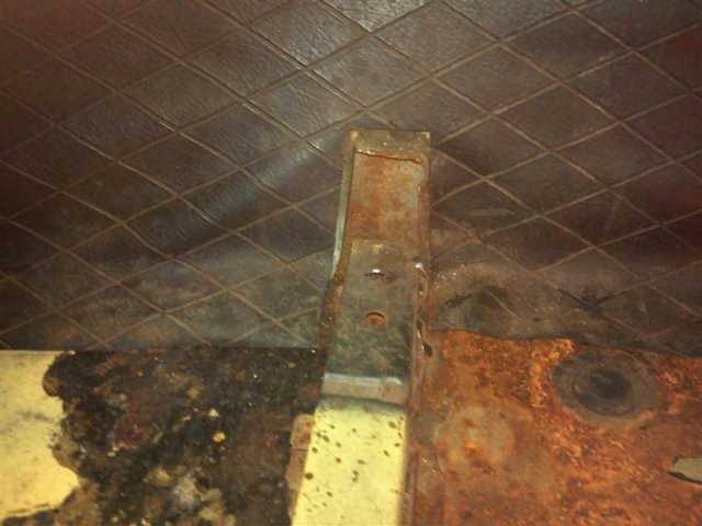

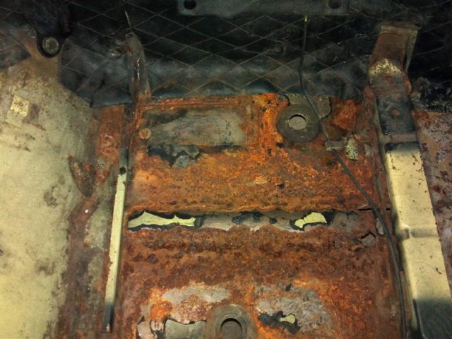

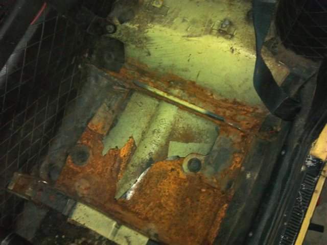

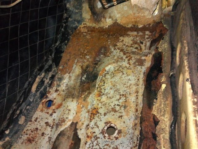

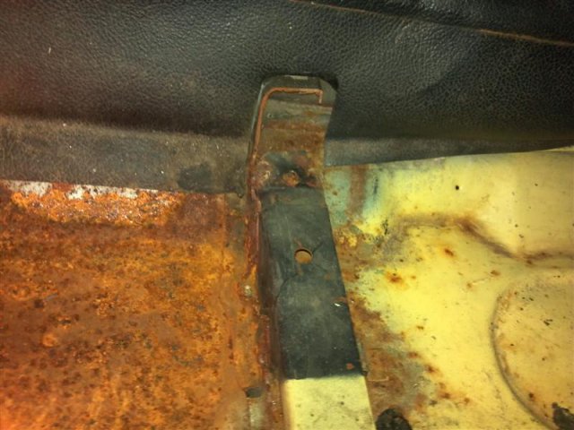

I need to replace/repair my floorboards. The Z I bought had non-Datsun seats in it; when I removed them today I saw that to make them fit the PO had removed metal to make them fit. Has the removed steel compromised the structure of the car? Should I look at getting replacement pieces for what has been cut away when I replace the floorboards? Also, I am trying to decide whether it's worth buying the Zedd Findings floorboards or whether I should just make my own from 16ga steel. The worst of the rust is clear up at the front of the driver's side floorboard and I'm not sure if they will even go up that far. I'm ok with cutting the floorboards myself but I'm looking for pros and cons. Additionally, the passenger floorboards are pretty solid but have some good pitting towards the front. I have all winter to work on this car; should I replace that one too? Thanks for any advice you may have

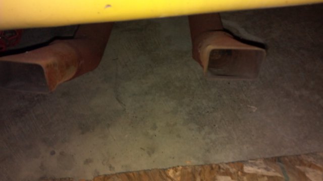

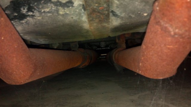

Hi all, I bought a 240z that already had the 350 SBC V8 conversion completed in it. It needs the vortec heads installed, but that's another story; I don't care for the exhaust solution that is on it now. It's a dual pipe setup that exits directly in the center of the car. It's all rusted to hell and since it doesn't have a fuel cell I'm not sure I'm comfortable with the exhaust directly under the gas tank like that. Plus, they hang really low under the car and I'm sure I'll be dragging with the smallest bump (I live in a rural area so nice flat city streets aren't always what we have to deal with). I've done a lot of searching and reading here but I'm not a person who has done a lot of work like this on ANY car so I'm not sure where to start. Plus the V8 exhaust stuff is all lumped in with the 6 cylinders, so it's not easy to separate the info for someone like me. I'd like to see what my options are for some good SBC exhaust setups from the engine on back. I'm going to be making the engine compartment look decent as well since I intend to show it off at some small local shows when I'm done, so I'll be replacing the rusty old exhaust manifold as well and would like something that will keep looking good for a long time. Any proven layouts that work would be helpful... specs, photos, anything! The stock cutout location for the exhaust has been filled in but I'm not against removing the filler and going back to stock location if that's a good option. I've attached my current setup below. Thanks!
