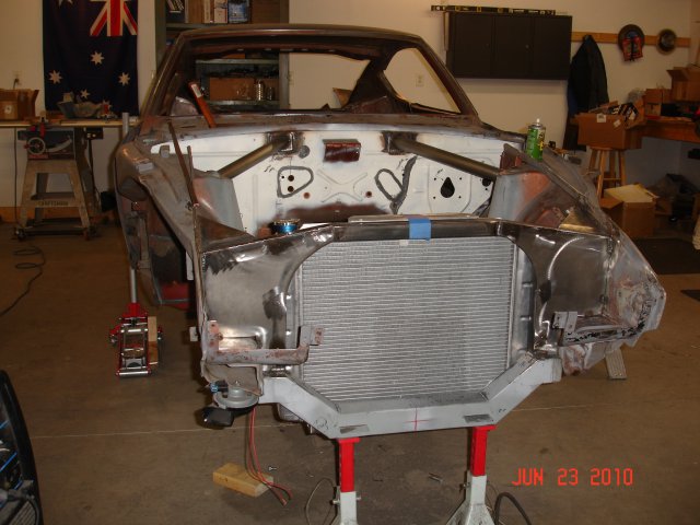

  7. Having some trouble figuring out the water inlet plumbing for the cooling system. I'm looking at a swivel inlet neck for the engine from Jegs, but at $120 I'm hoping for a better / cheaper answer. The problem is the engine coolant inlet and the radiator outlet (bottom port) are not aligned and routing a hose between the two looks difficult or impossible without a pre-bent hose. Wondering what others have done for this - pictures would be great. Thanks

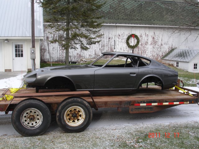

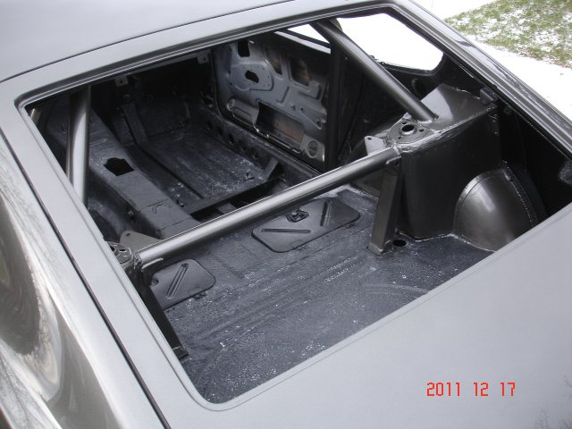

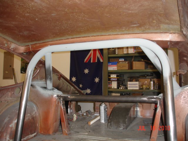

  17. Thanks for the compliments guys, its been a looooong process to get this far but to finally see it like this really changes my perspective. I don't know the paint code off hand but need to get it, and when I do I can post it. The plans for the car are, in a nut shell, LS1 and and T56, coilovers, rear fill fake fuel cell (aluminum tank), pretty stripped interior, disk conversions. I have and have test fit most of the parts already so I just need to do brake and fuel lines and build a chassis harness. But with work it still might be awhile until I can drive it. Here are a few more pictures of it, in-process. This site has been a great place to get some good ideas and inspiration from - Thanks Hybrid Z

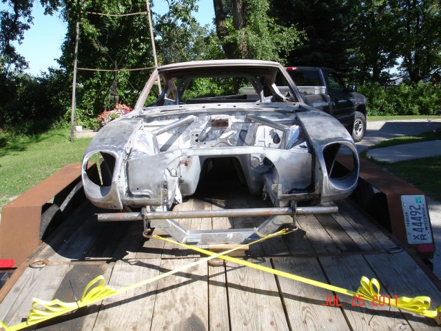

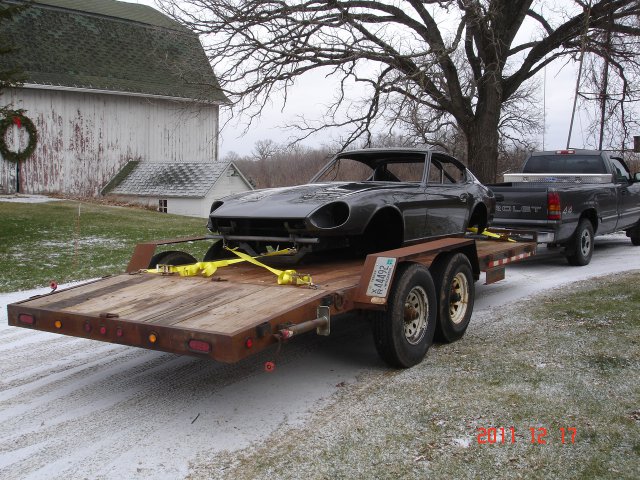

  18. Thought I would post up some pictures of my car, its been six years in the making but starting to see the light at the end....

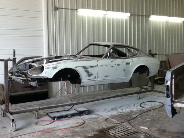

  19. here is where I'm at, car is still at paint shop (brought it there in August)... should be done soon....

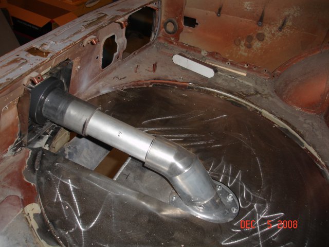

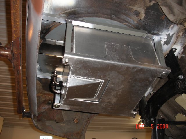

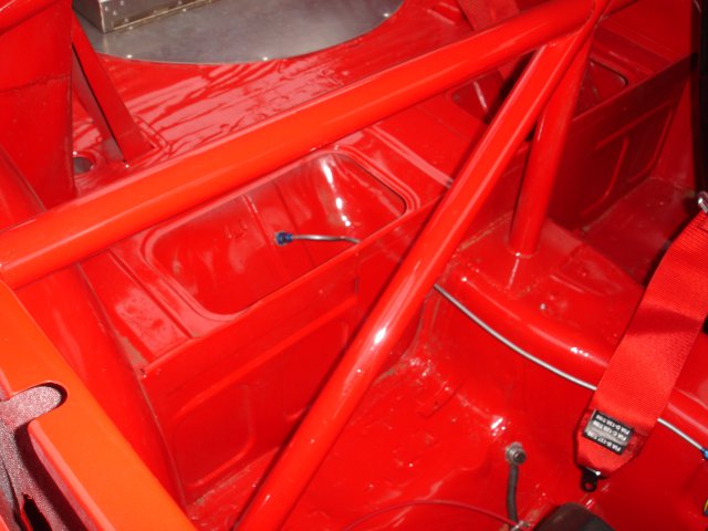

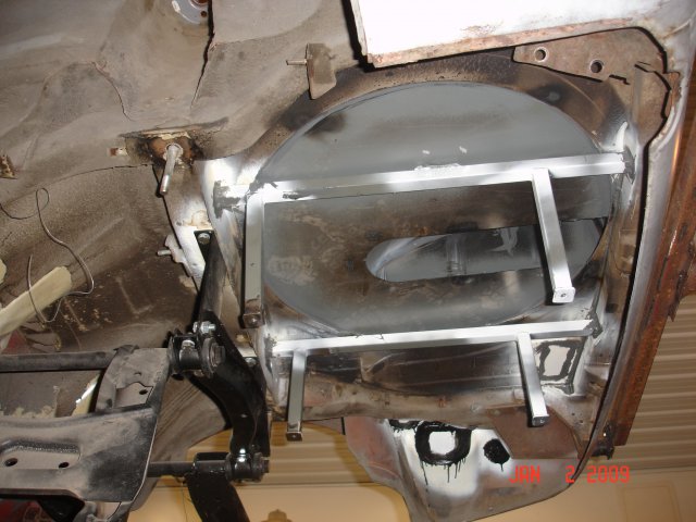

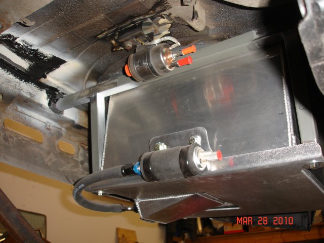

  22. Here are some pictures of what I got going with a remote fill. It is a 10 gal tank from summit, I cut out the spare tire well and added a closeout plate. A fill tube extends from the back of the tank to the rear of the car. I also made a cover for the tube so I dont get any gas vapor in the car
