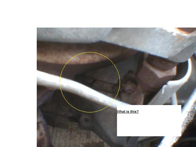

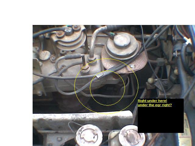

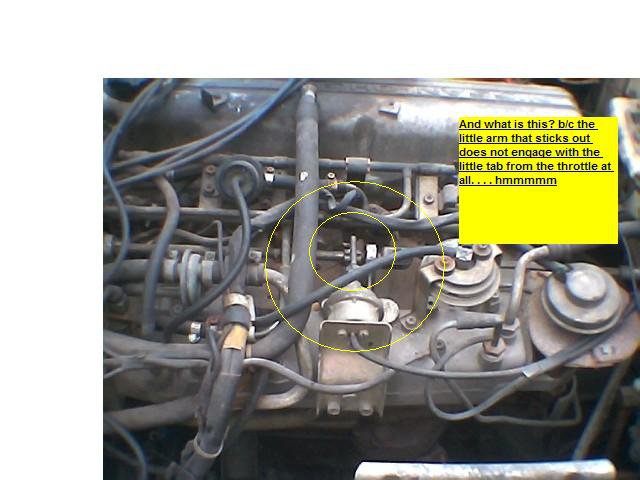

well thought i had exhaust leak looek what i found . .
PapaCreech replied to PapaCreech's topic in Nissan L6 Forum
Thanks everyone fixed it up! and guess what a weird effect has occured my car has completely stopped smoking hmm strange! -
Thanks everyoen for your help im goin out today to weld it up and seal off everything! thanks again Ron -
Its definently Broke in two not cracke, and should i jsut take it off ? no emissions. . as far i know 78 stock na motor. -
well thought i had a leak look what i found this morning, i have no idea what it is but i knwo tis broke clean in two. Its under the egr valve , coming out of exhaust manifold? Dont knwo what it is lol some one help ! Then a close up Then wht is this? Patiently awaiting all help thanks Z'ers:burnout: :burnout:
