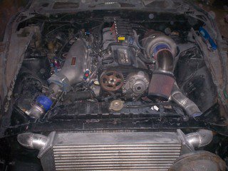

One thing i forgot tm mention to sooley.If you are going to run a GT35R,you will have to make a custom exhaust manifold so as to mount the turbo forward or backward of the strut tower.I had a "off the shelf" stainless one and the turbo is around 1.5 inches higher than the hood.I had a scoop on it but im in the process of making a custom steampipe manifold.It cant be lowered either because the turbo wont fit between the engine and the tower with enough clearance.This is mine with the old stainless manifold on it..
I see some boost by 2800 and full boost by 3800.Rev limit is 7500.It is fairly quick to get onto boost as im running 8.3 cr (standard rb30e pistons) so its still got the torque of a n/a 3 liter. It made 546rwhp on 15psi so i havnt felt the need to go any higher than that(the turbo is also out of flow) Im running a tial 40mm external gate. I was going 12,13,15,15 psi but now it goes 13,14,15,15 but with a slower boost curve.
