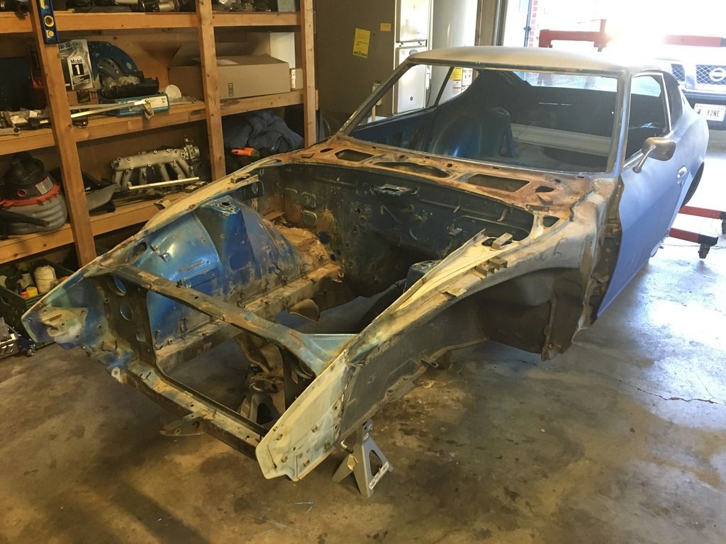

Front of the car disassembled:
I'm not sure about how to go about cleaning all this up. I'm guessing a wire wheel to most of it and an angle grinder for the surface rust will be one of my only options without media blasting. I'm also considering removing all the flexible wire keepers attached to the sheet metal in favor of a real fastener system for engine bay organization.

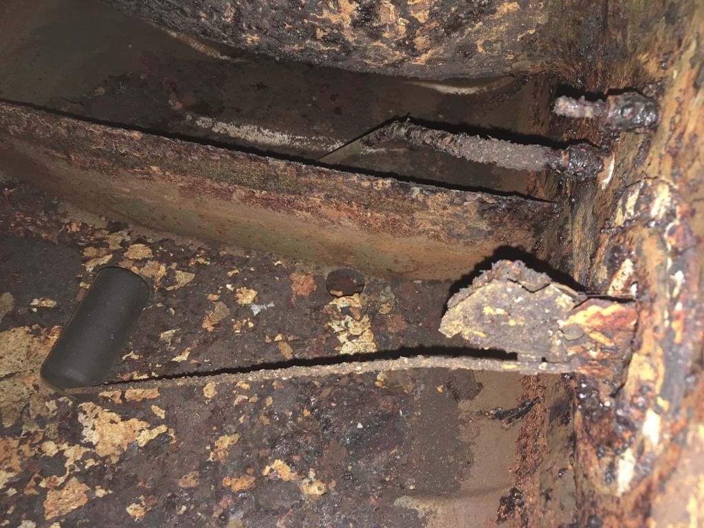

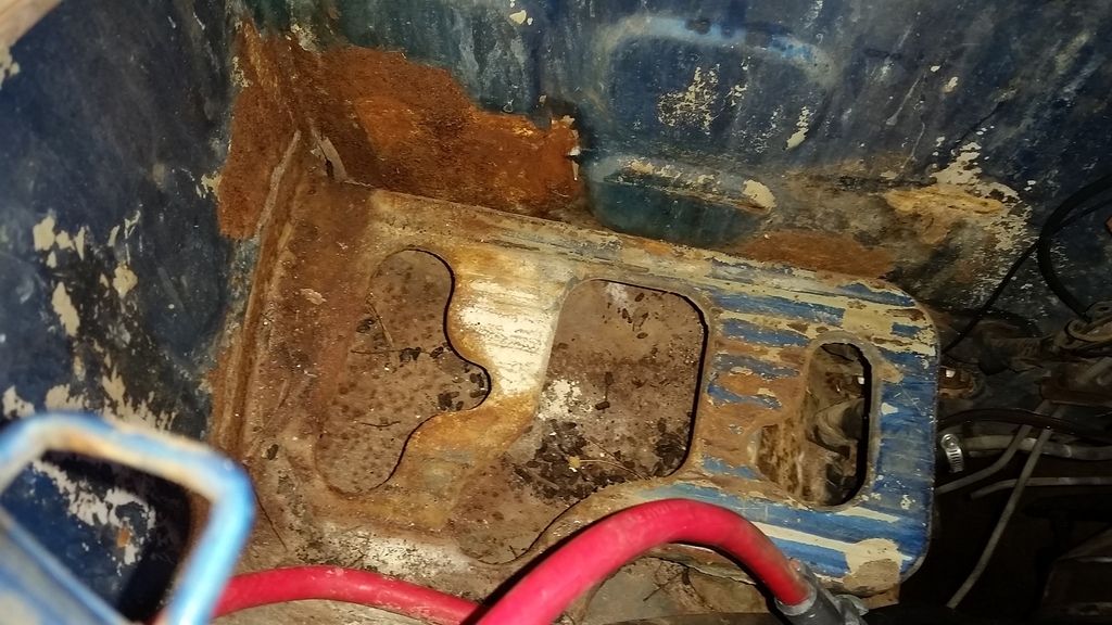

Better view of the rust underneath the battery tray:
It's eaten through the firewall into the passenger compartment:
Will be a tricky area to repair, I'm going to save it until I'm practiced up. First areas will be the floor pans:

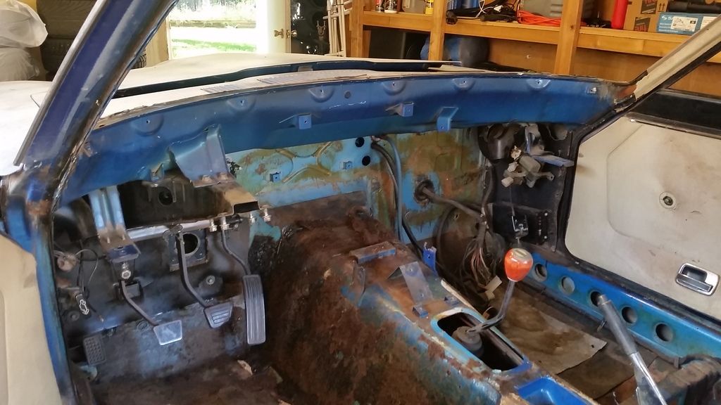

Seats out:
Dashboard and windshield out, they were surprisingly easy:
Removing the tar mat sound deadening was by far the most time-consuming part of stripping the interior. I removed about half of it with a paint scraper and hammer, the rest I used dry ice on to make it brittle and then chipped it off with an old screw driver:
The rust on the driver's side floor pan didn't turn out to be as bad as I thought it would be, I'm hoping to be able to get away with two or three patches and then wire wheel/rust convert the rest of it. The passenger side, however, turned out to be a little worse. The battery tray rust has not only eaten through the inner fender, but also about a 5" section of the firewall, and the floor pan has various rust all the way back to the front seat rail. I'll decide how to deal with it after I clean up the metal and see the full extent of the damage. Prevailing opinion is that replacing the whole pan is easier than many small patches but I'm really trying to avoid that if I can. I'll post some more detail shots soon.

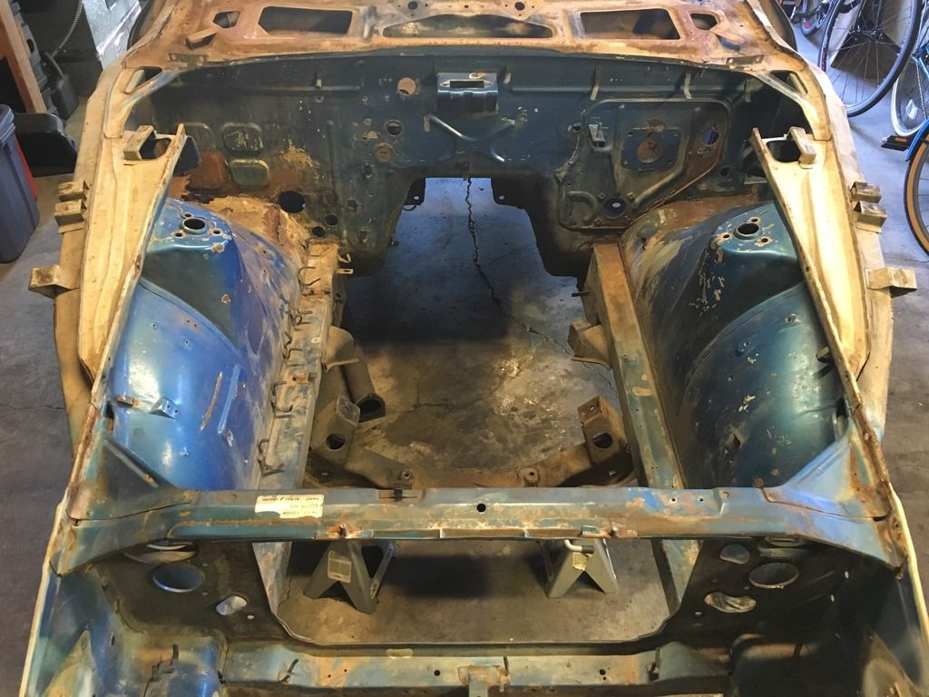

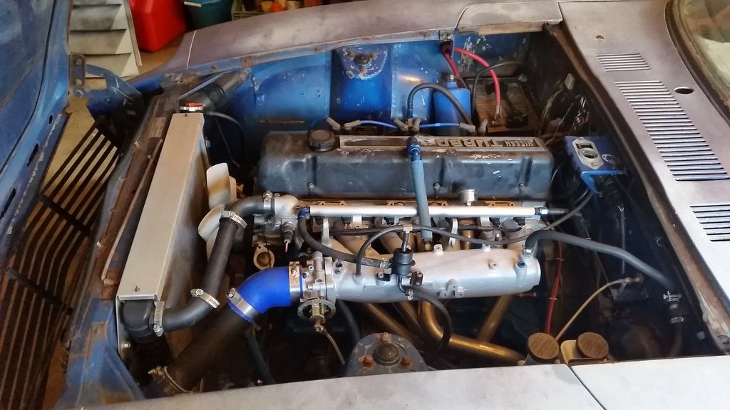

Current engine bay:

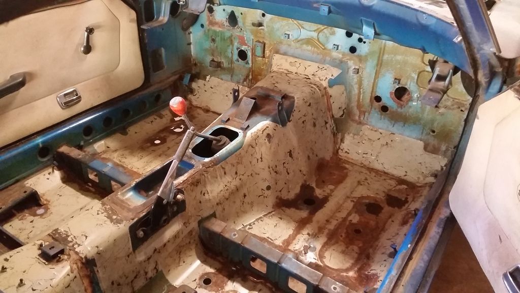

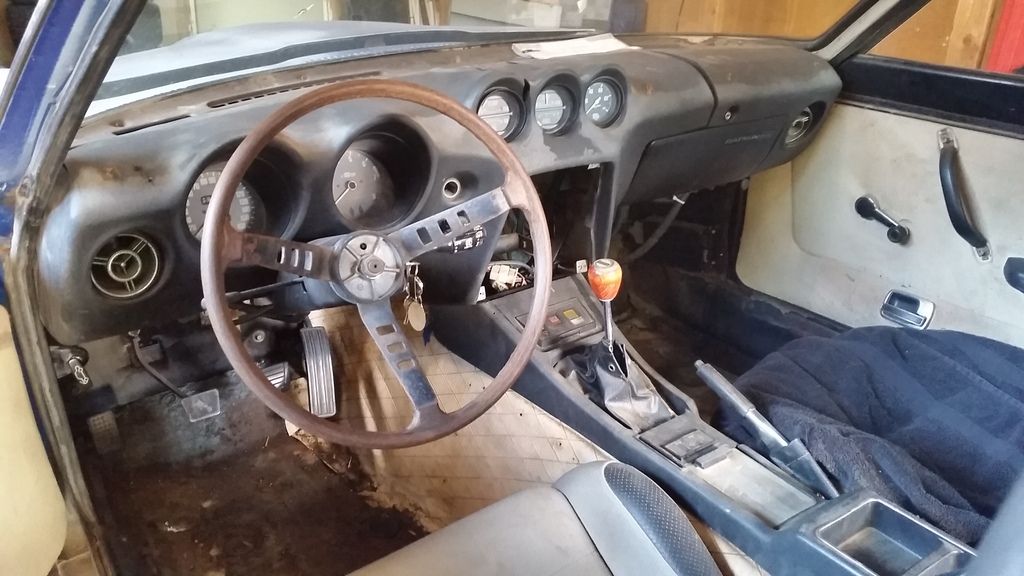

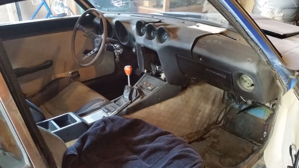

The interior needs to be completely removed:
It's going to get a fiberglass dash, new gauges, matching seats, some light sound deadening and simple black cloth.

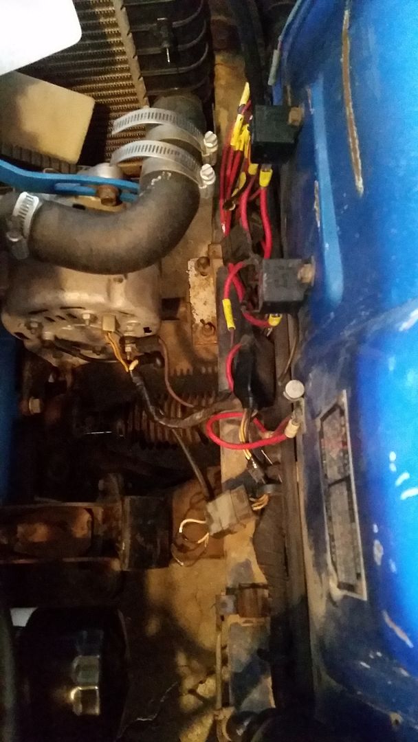

The chassis wiring is also in dire need of attention:
Most of the wiring is original and/or hacked to pieces, and I don't need half the circuits in the car (seat belt buzzers, door switches, radio, hvac, etc can all be removed), so I'm just going to rewire the entire car. I was looking at Painless harnesses but unsure of the most cost-effective route, or if other brands may offer something more suited to my situation. I also would like to pick a style of connector to use throughout the car for consistency (or at least one for interior wiring, one for engine bay/weatherproof wiring).

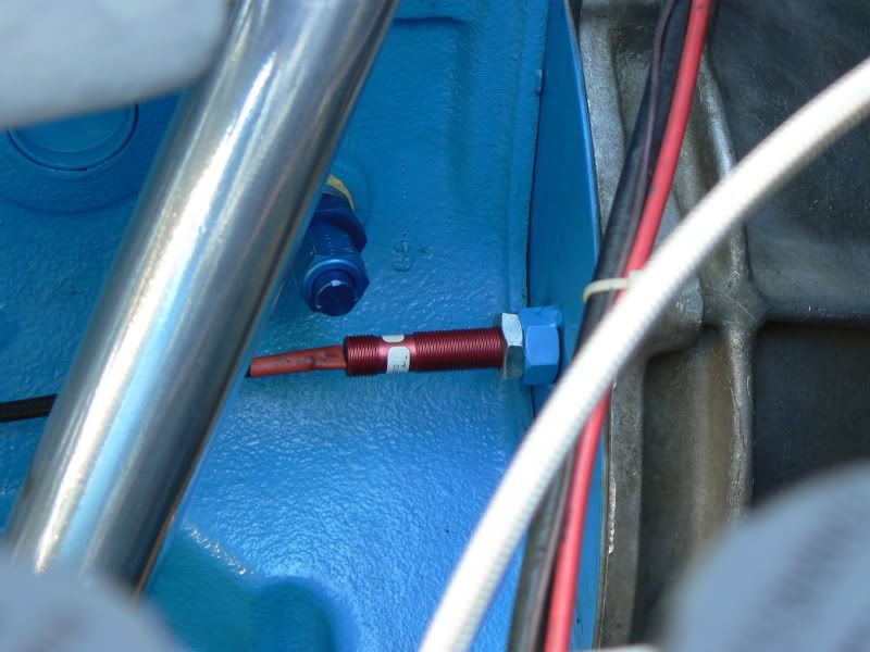

I wanted something flywheel-based; simple, light, and dead accurate. I chose the Cherry GS100502 geartooth hall sensor for its ability to read a 'gear tooth' pattern. It doesn't need magnets, it simply switches based on the presence/absence of a ferrous material in front of its nose. That's perfect for simply drilling the pattern of your choice into the back of a stock steel flywheel. For wasted spark, the pattern must be based on an integer multiple of the number of cylinders. MS will accept either one or two missing holes, though I will cover only one missing hole here. For example, common patterns include 6-1 (6cyl x 1), 36-1 (EDIS pattern, 6cyl x 6), or someone adventurous could do something with the flywheel teeth, which are 120 count (6cyl x 20). I chose the 6-1 pattern for simplicity of machining; some say it will be less accurate at lower rpm, but in my opinion the difference in error between a 6-1 pattern and a 36-1 patten is going to be smaller than the error in the rest of the system anyways, so it's absolutely no matter. My flywheel, with a quote from my build thread regarding machining:
The arrow points up at TDC, and that tic mark on the 2 o'clock hole denotes the sensor's position (again, relative to when the motor is at TDC). Note that this will create a trigger angle of 90 degrees, give or take depending on exact sensor placement. It was easy to measure/mark precisely where the holes needed to be by using the fact that there are 120 teeth on the ring gear. Some careful work with a dial caliper and I was able to be sure the marks were right on the money. I made sure the hole depths were plus/minus .001" of eachother (to ensure the material removed from each hole was of equal weight), then drilled an identical hole (size, depth, radial position) where the 'missing tooth' would be, but on the opposite face of the flywheel, to keep it in balance while still providing the 6-1 pattern the computer needs.
I found the correct M12x1.0 nut and tack-welded it over a hole drilled in the engine backing plate to place it over the flywheel holes. The sensor threads in here with a jam nut to hold it in position (be gentle on those fine aluminum threads). I screwed the sensor all the way in, then backed it out 1.25 turns for a 1.25mm (.050") air gap. This was a pure guess, but has worked flawlessly for the past six months.
The sensor wiring is simple. I gave the power wire +12v from S12 on the MS board, the signal goes to pin 24 on the MS board (tach wire in the DIYAutoTune harness), and the ground to pin 2 (tach wire shielding). Internally, wire it as a Low to High sensor (it will ground when the flywheel is in front of it, which is not a tooth, the hole is). I made these internal connections on my MS-I V3.0 board:

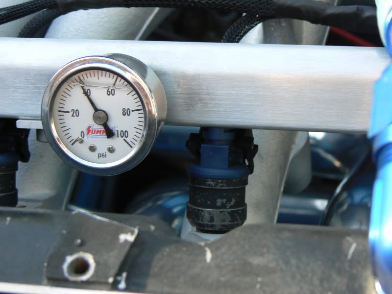

I've had the car running since Friday night. I couldn't be happier with the new setup. Nice lumpy idle, power all the way to redline, and plenty of torque right off idle for driveability no worse than the turbo motor. This engine coupled with the 4.38 rear end pushes you back in your seat just as hard as the turbo motor at 12psi with the 3.36.
Progress, now that I'm through twiddling my thumbs waiting for the headers to arrive. First, this is a lot of lash pad:
.290" on all valves. Some were alright at .280" but it was easier just to make them all the same. Kinda scares me how tall they are.

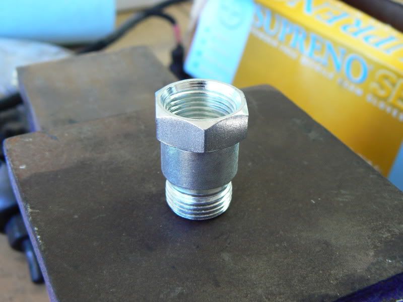

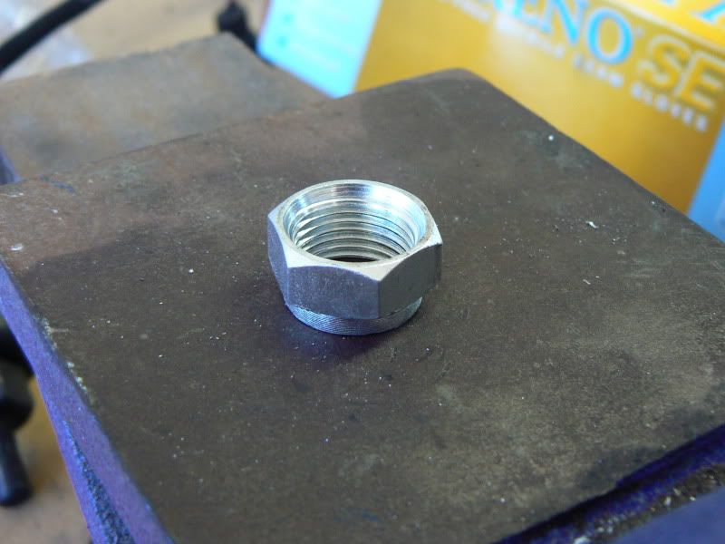

Next, how to make an O2 bung for $2. First, buy an 18mm spark plug non-fouler (usually a 2-pack for $4 or so):
Then, cut off the top and discard the rest. Bam, correct size/thread pitch steel bung ready to weld in.

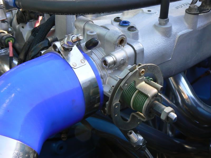

Headers in, brand new 6-1 ceramic coated. I had to have the flange flattened, it was warped well over .100" right out of the box. My machinist bent it closer to straight in a press, then took off about .060" to make it truly flat.
As the car sits now, the intake is bolted on, throttle cable hooked up/adjusted (amazingly smooth), etc. I hope to fire it up tomorrow afternoon, or Sunday.

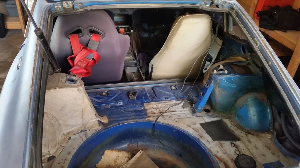

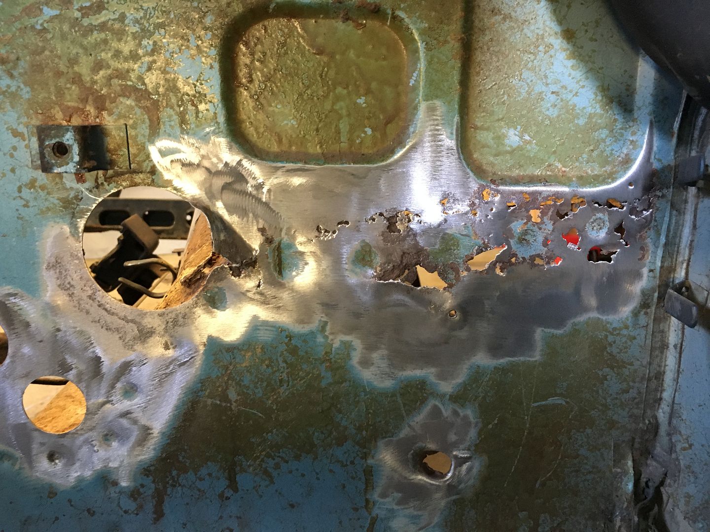

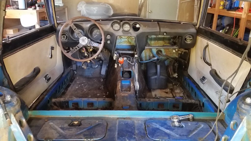

Mid-progress pic, making my way down the firewall and into the trans tunnel. Incredible difference:

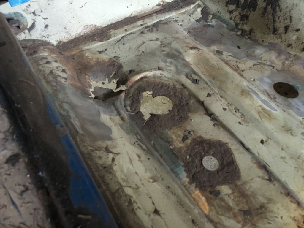

Slightly visible in the pic above, the floor pans and frame rails are arched upwards from the front of the floor pan back to the front seat brackets, probably from a hard wack on a speed bump at some point in the car's life (I swear it wasn't me). Other than being a bit dented up, the frame rails and floor pans are generally fine, and I think I'm going to try to save them by straightening them as best I can and patching what holes the floor pans do have. I think a slide hammer, a dead blow mallet, and a block of wood should do the trick of getting them mostly true. From the front seat brackets back to the rear subframe the pans are straight and solid, so I'm going to add Bad Dog rear subframe connectors and tie them into the stock rails. At some point in the future I may add full Bad Dog rails and do more work on the pans, but this isn't a show car so I'm not worried about re-doing any paint or undercoating.

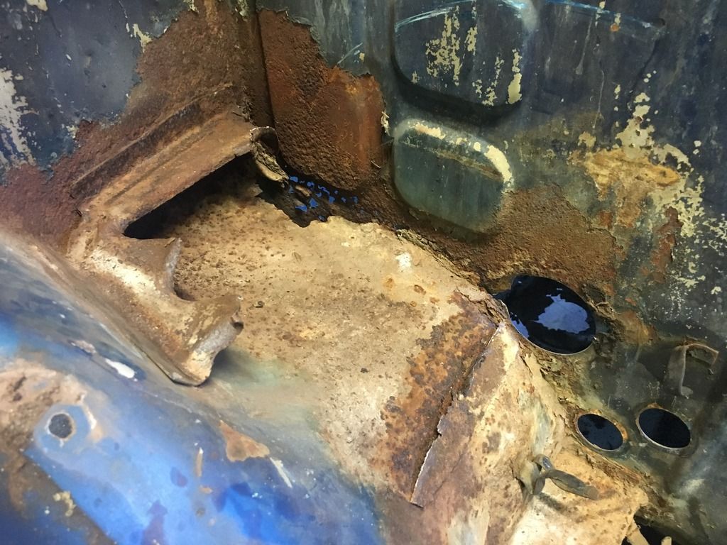

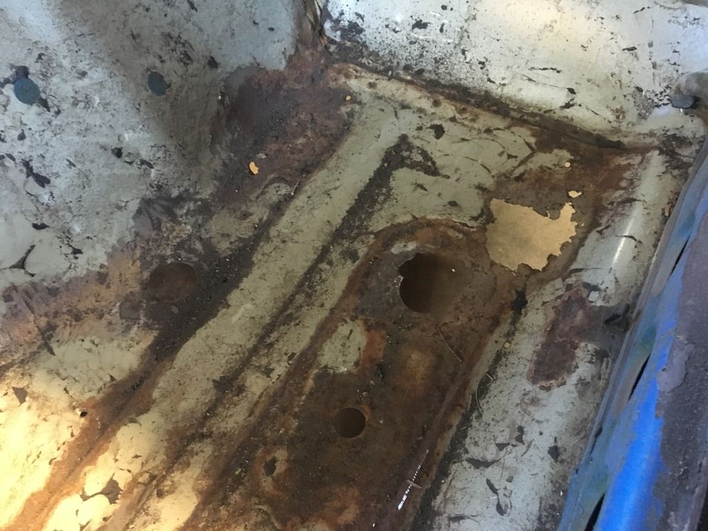

Here are some better pics of the floor pan and battery tray rust:
