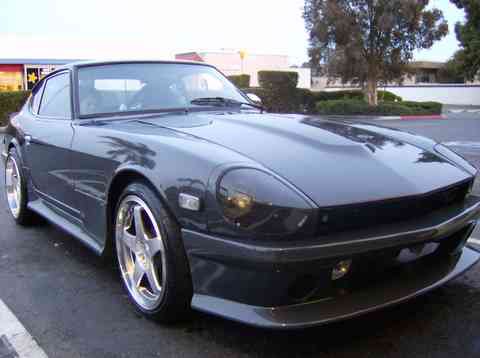

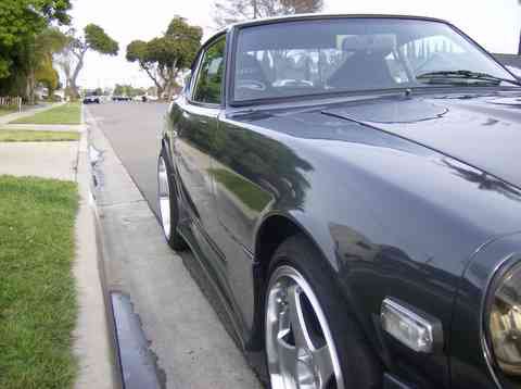

  7. Rear: i run a 265/35/18 tire on an 18X9.5 wheel (tire is streched a little) Front: 225/40/18 (streched a bit more than the rear) tire on 18x8 wheel with a 35mm adapter/spacer no problem in the front whatsoever Rear i had to roll the fender lip, big baseball bat works good. Also, i dont think i could go bigger than 265 tire because im useing tokico 4" dia. springs.... i will be going to coil overs then i can run a 295 tire.. Edit: MSA said i couldnt fit those rims & tires, but i machined my own wheel adapters and showed them! http://www.cardomain.com/ride/2314369

  14. 25mm adapter rear 35mm front.. tokico coils..4" my wheel offset was 38mm...planing on coil overs soon i want to be able to fit 275+ tire and lower it a bit more i did roll the lip with a 3" alum bar stock but not much

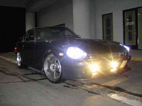

  16. yes, 10k hid bulbs and i removed the shroud around the bulb with sheers. the others (yellow) are hella 500's with ion yellow 100W.. 265/35/18 rear tire on 9.5" rim. front=225/40/18 on 8" rim..
