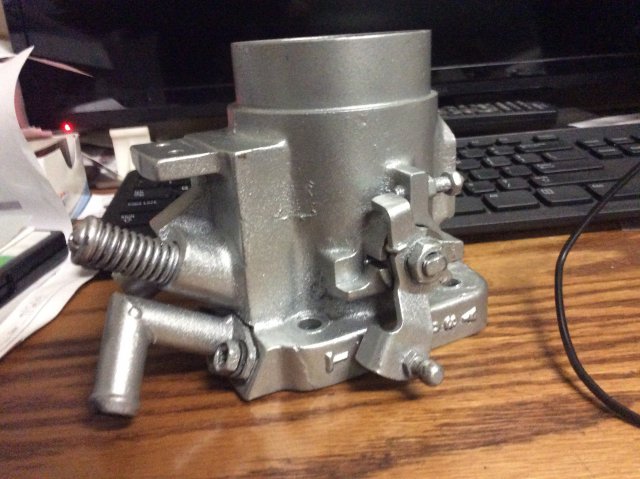

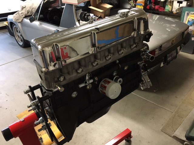

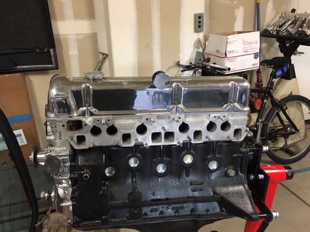

	I’m asking this here because this is a Z specific forum. I’m dressing a Rebello built 3.0 stroker for use in my 240Z. I’m using Haltech Elite 2500 and I’d like to do drive by wire. My intake is a 280Z that has been extrude honed. I have a TWM Big Throat throttle body but I’m open to anything that gets me drive by wire. What have others done? pictures for interest.

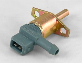

	On a slight High jack of my own thread, will MS3X fire the stock cold start injector? And yes, I realize that's not the original.
