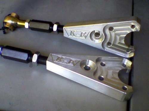

  1. Those K-E front LCA look great to me and for the money he has a newwer auction (just for the LCAs) $275 with shipping 10 more dollars and they'll be anodized I want a set

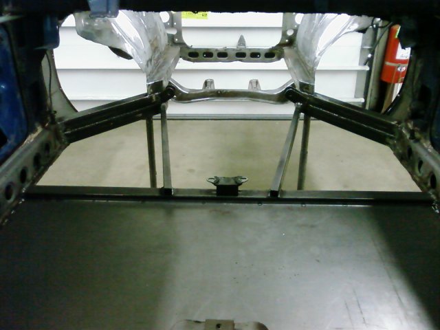

  8. ckrell

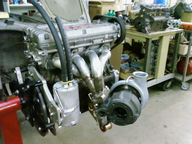

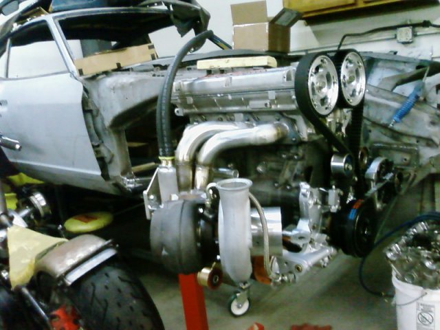

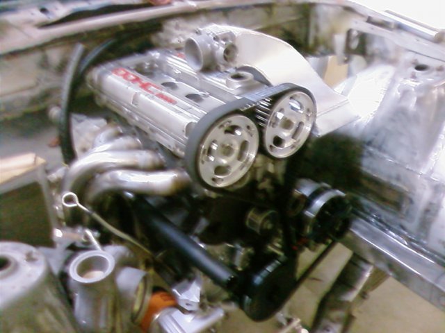

    My project is slow going but getting there 2.0L 4g63, ross pistons, 272 hks cams, oringed deck, HX40 (60mm) reverse step stainless twinscroll header, eagle rods and other work, 30psi boost with E85 + methenol injection

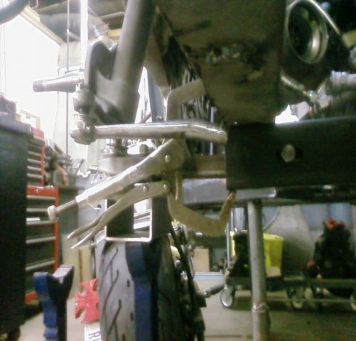

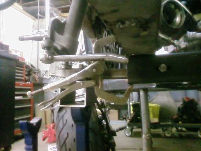

  14. I'm in need of r200 wheel axels and companion flanges for 240z what do you have??? GOT WHAT I NEED THANK EVERYONE
