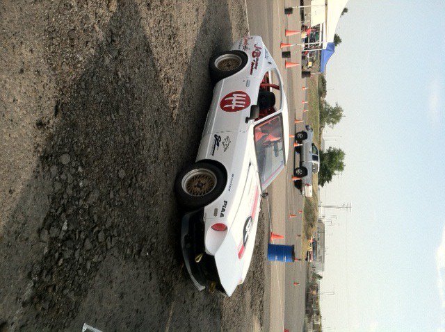

CHUMPDATE Well we finished 9th out of 30 cars at the 24 hour Chumpcar enduro in Spokane, WA this past weekend. We had a blast, and the car ran great. We had an electric fuel pump fail early, which cost us about 20 laps, and then broke a rear wheel stud changing tires which cost us probably 20 more, I also spun, and made an off road excursion that cost about 10 more laps (I pulled the wiring off of the electric fuel pump when I went off road and had to be towed back to the pits) or we might have been on the podium. (I know a lot of what ifs, and if it was not for that!) My engine ran FANTASTIC. Water temp was rock stable at 190, and oil temp peaked at around 225 during the heat of the day. I ran the beast up to 6200 in 5th a number of times, with 3.9 R200 rear, so the car goes! Huge thanks to Peter from PMC for all of his advice and mentoring. My buddies/teammates did sneak it onto the dyno last week while I was traveling, and they fessed up during the race. The engine made 178 horsepower to the wheels on their new Dynojet 24. The old engine made 136whp on the same dyno. I will try to get them to print me a sheet so I can post it. Ambient air temp was over 90F when they ran it, and maybe even hotter inside the shop. They made one pull with the air cleaner off, and made over 180whp. There was only one car on the track that could out pull us on the straits, and it was an E36 Bimmer (I know, how is an E36 a Chumpcar?!), and it just BARELY out pulled us. The Bimmer won, but was dropped a place when they discovered the ECU had been "chipped" during post race inspection. Lets see, you some how manage to convince Chumpcar officials that you can buy a running, driving E36 for under $500, and then you still have to cheat to win? What a bunch of douchebags! My buddies may run the Z one more race this fall, and then the engine comes home and I'll open it up to see how it fared.

OK, back from the track, we just finished our afternoon heat race. We were in a field with mostly pro3 Bimmers. Engine finally is coming to life. Turns out they run better with all 6 spark plug wires on. We were running on really shot Toyo 888's, and ran in the middle of the pack with some very expensive company. The car ran consistent 1:43's compared to 1:47's with the same driver with the old engine during the last Chump race. I am pretty proud of our old Chumpcar, and particularly my L28. We will finally get it on the dyno next week, and see how close our seat of the pants tune is. Next Saturday, the 21st, we hit the track for a 24 hour Chumpcar enduro. I get to drive 3) 2 hour stints, assuming the car stays together. I was not able to drive the car this weekend as I do not have a conference license. I cannot wait!
