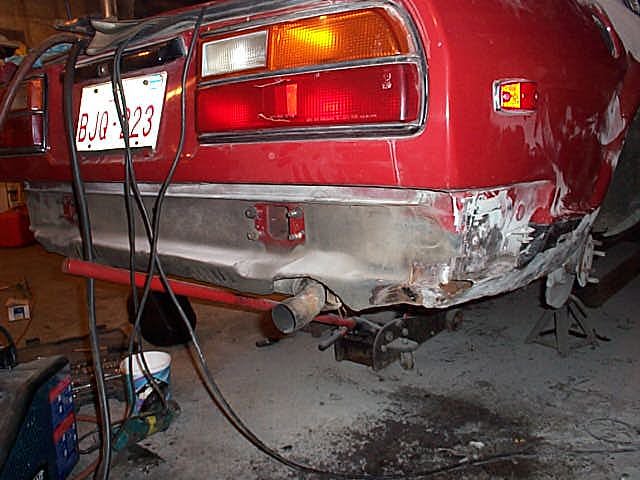

  6. YA that what I am planning but do you have any in progress pics , I am planning on shaving the markers too, and actually the door handles and installing openers, if my son can source them, So are you saying use the fibreglass strains on all the car repairs or just the rear bumper? thanks for the reply , I have been trying to find some pics for awhile now. ONly diff mine is a 81 and it has a offset line on the lower side which has to be dealt with, here is a pic while I was buying it btw how do I add captions like you did above to pictures?

  16. Here is the rear end pic- this is what I have ,sorry I was so long replying I was repairing a hole in the spare wheel area tonight,
