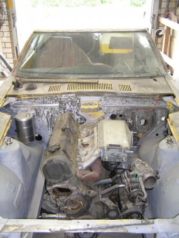

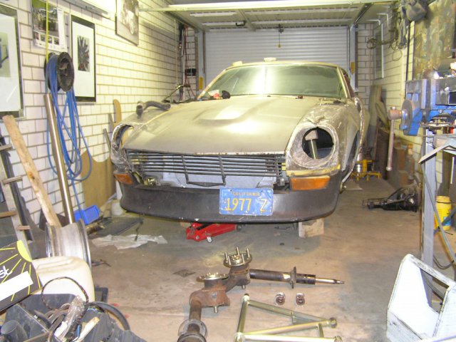

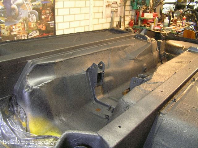

	Here is an update from the corrections i made on the rear wheel ach and suspension member I had to put extra weight in the trunk to simulate the complete car when finnished. This is the ride height with 240z shocks and Jim Cook racing springs in a 260z body with high shock towers. Put an engine in for a test fit Have Fun, greedz Jack

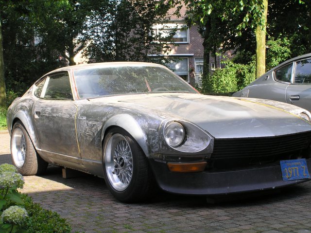

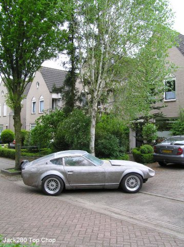

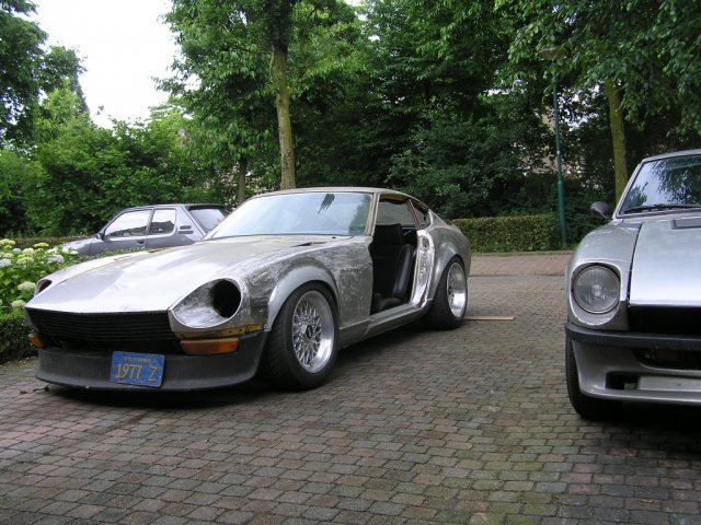

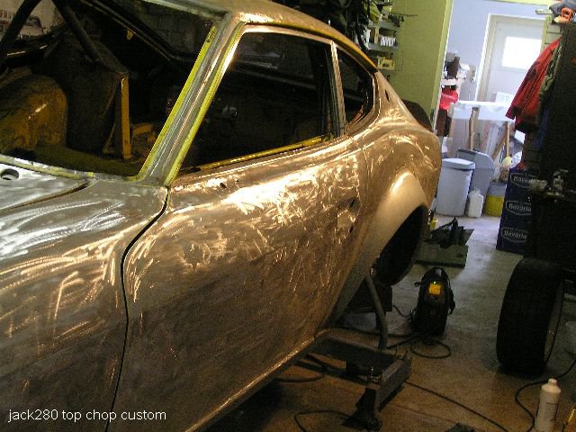

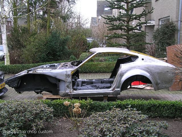

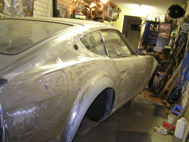

	Hi guys, thank you for the comments on my car. If you want to see more pics and updates go to the link in the bottom of this post. If that doesn't work, go to fabrication forum or search for top chop. I'm only updating in that topic. I don't know how tall 6'5" is but i am 1.84 meter and raised the floor 35mm and chopped the top 50mm. The seat is tilted backwards and mounted on the floor in the back. In the driving position I still have some 5 cm space. When I had to do it again my first goal would be door glass that fits from the start and build the rest to fit the glass. In my case I have to cut side glass from a truck front windscreen. When I started to lower the roof I completely removed the front windscreen frame including wiper mount ant tilted it backwards. Now I can use a stock windscreen and I have to modifie all body panels around the windscreen fo a proper fit. I am still using the stock doorglass frames to keep the classic style of the origional car. And when I had to it again, I would start with a tuned s30 so only the chop had to be done. If You want more information. Go to the fabricaton forum. Greetz Jack

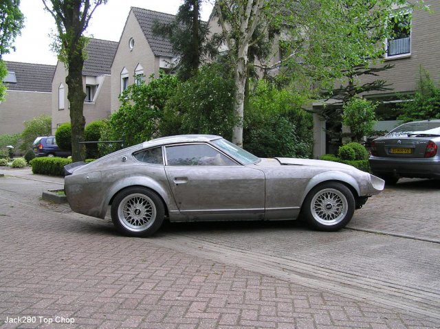

	Is this Datsun HEAVEN? This is max droop just to check clearance Shakotan Style is not realy usable in the Netherlands with all the speed bumps

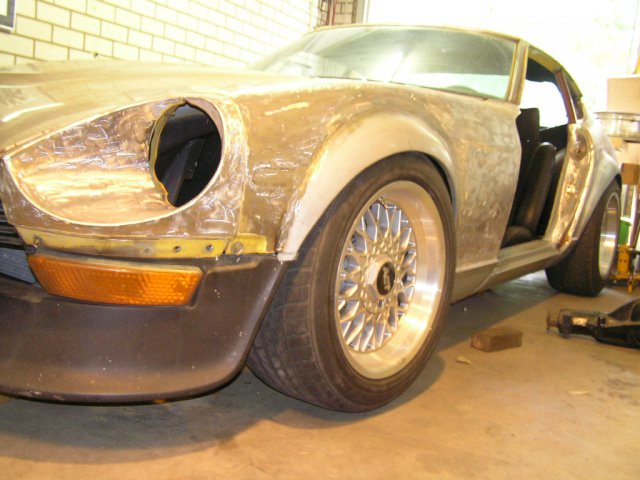

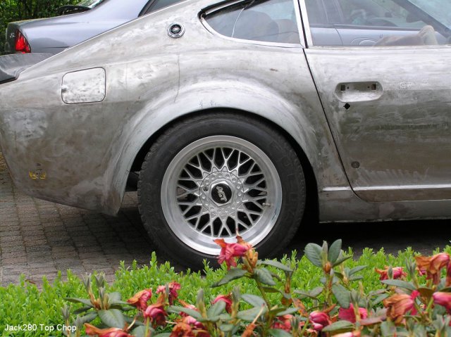

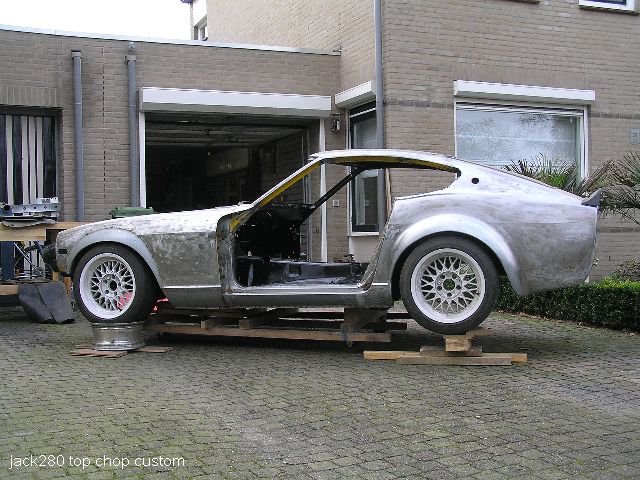

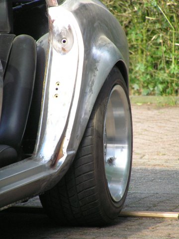

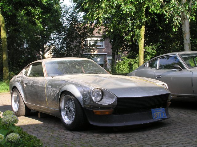

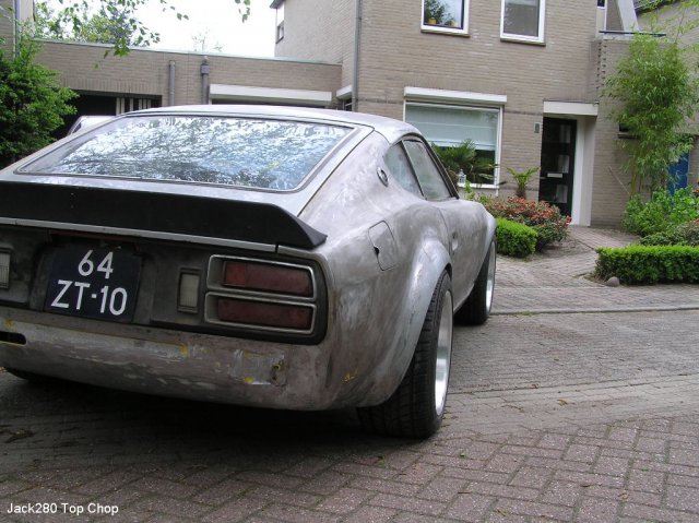

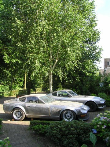

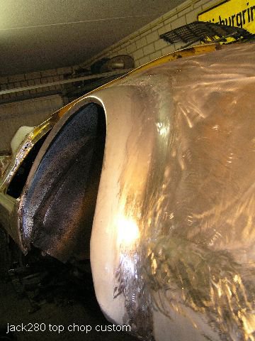

	Hi guys, I'm not building my car with 15" wheels but with 8,5x16 with 225/50-16 in front with 25mm extra length lower control arm, and 9,5x16 with 225/50-16 in the back. Rear control arms have 30mm extra length and I hammered the flares out of 0.8mm sheet metal. It was a lot of work to fabricate the fenders and weld them, all seams were body soldered and filed flush with the body. The wheels are from ACT and came from an old BMW 535i. It is just to give an idea how wide you can go with wide rims, wide flares and/or wide control arms. On the pics have only the hood and bonnet paint When you look at the car for the second time, you can notice the top chop roof. more pics on the link below http://forums.hybridz.org/index.php/topic/107335-top-chop-update/page__p__1004250__fromsearch__1#entry1004250

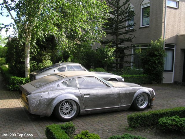

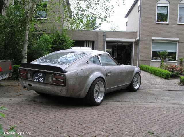

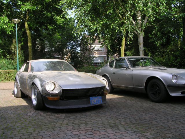

	Hi guys, In a Sleepless night a couple of years ago, I had such an idea. Lets chop the roof from my s30. My first nightmare was that it should apear like the car above. Now after years, its first apearance outside. these are the only pics in this topic, see more in http://forums.hybridz.org/index.php/topic/107335-top-chop-update/ I know now how much work it is to top chop your 240z s30 datsun, the man who Chopped this top had a vision I guess. But you have to love the result. Greetz Jack280

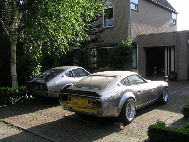

	I wanted to put the car outside today, but its raining today. Hopefully tomorrow dry weather. Here are some pics from first time on its wheels. Its to low in the front for steering clearance. maybe tomorrow more pics. Jack280
	Some new pics from rear suspension parts and supercharger / engine mount. fitting stock windscreen without cutting glass experimental quarterglas cut from a front windscreen from an old Bmw E30 Experimental door glass cut from a 7mm truck windscreen, the shape / curve from the glass came close to the stock curve of the s30 glass. To cut the glass I searched youtube and spoke to some glass cutting craftsmen. After that looking for some glass and the right tools. A simple glass cutter from 12 euro didn't work. I cut an aluminum template and started with the right tools and glasscutting oil. To cut out the first usable piece took a lot of patience. The lower part of the glass has to be cut loose with a razorblade, lit on fire and cut. The truck glass was only to practice cutting, sanding and polishing. Now I have to find better glass from the right thickness and shape.

	For the rear suspension i am using 240z struts with stiffer red koni shoks, the suspension tower from a 260/280 is higer positioned in the bodyshell. In combination with jim cook racing springs, i have a low combination. To fix the ride height, i have to make some measurements for the thickness of my topmount. The flange is welded to make it circular than machined with BMW 5 lug and arp wheelstuds. The trailing arms are from chromoly tubing. I hope to make soon more pics.

	I Resized some pics from the picasa link fom the datsun s30 260z top chop front view with modified window trim 40mm raised bottom with straight chassismembers to create ground clearance, body in under body protection sealing the weld with lead free body solder diy rear fender from 0.8mm steel after filing the body solder eaton m90 supercharger modified setup to fit datsun l28 with charge cooler from jaguar x300 front view l28 engine tilted to create space for supercharger side view 50mm top chop with custom steel wheel flares mockup with wheels on ride height lens cover test fit custom mustang shelby hub with oem s30 bearings to fit BMW525 front disc and diy coil over setup long tie rod with inside BMW joint and outside an euro spec GM joint and modified oem rack and pinion 16x9.5 ACT rims from an BMW E34 535i with 225/50 16 tyres in the back wheel on ride height and still 60 bump, thanks to 240 rear legs in a 260 body There is a lot of work to do, but when you want to do it the proper way it will cost a lot of time...............
