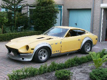

  10. I lowered the roof at the topcorner of the windscreen +- 50 mm and tilted it backwards 5 degrees. the roof was shortened +- 40 mm and i put the complete windscreen channel +- 15 to the front. When you just tilt the frame backwards, you will get a gap in the middle of the windscreen where the hood ends. For the rest of the story, look back in this thread. this is the link for the pictures. http://album.hybridz.org/showgallery.php?cat=891

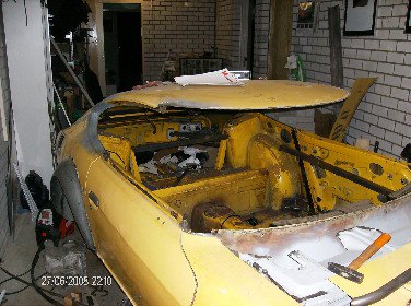

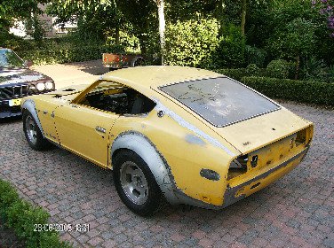

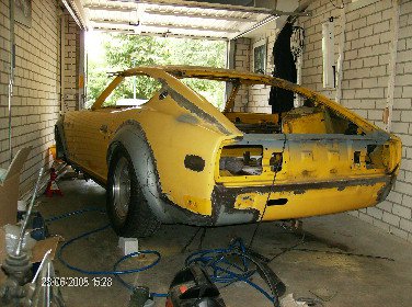

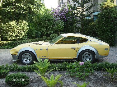

  13. Two years ago, i started with my project. The plan was just paint it and drive it. After removing all the rusty spots, i made new frame rails to get a straight floor to lower the car 95 mm, after that i made steel fender flares to add 25mm in front and 40mm in the back. After that i was thinking of a top chop.Two weeks ago it happened. I cut out the front window frame and raked it 5 degrees back, lowered the roof with hood in one piece. after a day and a night welding and grinding, the stock windscreen still fit in its frame. The result is that the car is looking much wider than stock and most of the orig parts still fit like hood, bonnet ,suspension and crosmembers. My only problems to solve are the door and quarter windows from bend lexan,because i want to open it like original and i still use the stock modified frames and rubbers. After putting the car on the wheels, the height of the car is 1150mm and the lines of the car are only getting better. This is still al lot of work to finnish this job, but to cut the car from front to the back will be much more work. Good luck with your projekt.
  14. I think that we have the same ideas about the modifications of a Z. In july 2006 my project started with a rustfree body and a lot of spares. After a little planning and a lot of work, now i have space to lower the car almost to the bottom. I replaced the chassismembers and raised the floor. After creating new fender flares i am looking for the different collour codes for a '77 280z. Is there anyone who can help me? Greetings from Holland
