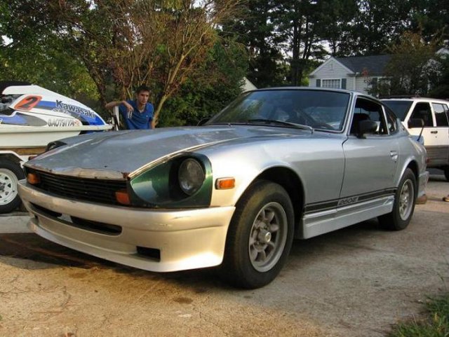

Well after a few weeks of shopping around, and seeing many MANY rusty old z's, i found this gem about 10 min. from my house. Its a 74 260z build date, 9/73 (its an early one, with a 3,000 something build number). The paint looks to be quite a few years old, as well as the body kit addition, there is some rust showing, but the rockers, and frame are virtually rust free!! Lights dont work, needs a carb rebuilt, and the brake booster has a huge vacuum leak. It has the dual weber down draft carb conversion and a header installed. But, i was able to drive it home, and im extremely happy with it! Future plans are turbocharged forged L28 motor, 5 speed, and 200mm rear end, megasquirt, roll cage and guting the thing for some fun at road atlanta. BTW, anyone interested in the set of Mini Mag wheels that are on the car? Linky--> http://www.cardomain.com/ride/2471921/1
