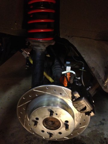

Hey, thanks for the fast replies. Ive actually reversed the L and R calipers because both the parking brake cable and the brake line sit better that way and the cable doesnt rub on the halfshaft. I tried what ritrebor did and rotated the calipers a little while bleeding them and I think that took care of it, I'll find out when try them tomorrow. Thanks again, guys. -
My dad bought me a rear disc conversion for xmas with maxima calipers and I have installed the kit although the kit did not come with instructions. For some reason the calipers refuse to clamp down. I know they are bled fine because I have tried bleeding them multiple times and I have also tried switched the calipers. Supposedly these calipers are self-adjusting but I feel like they are not adjusting as they should. I am having trouble finding any information for troubleshooting so any suggestions are welcome. thanks ian
