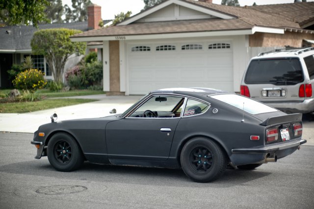

  14. Here's mine Panasports 14x7 215-60-14 front 225-60-14 rear offset unknown
