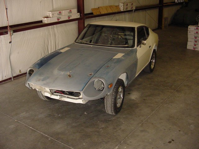

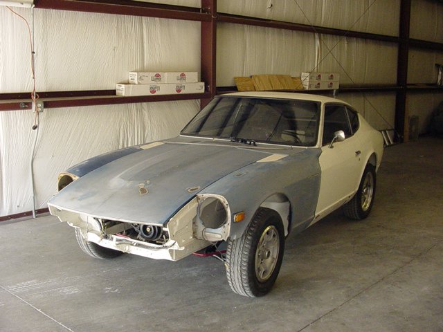

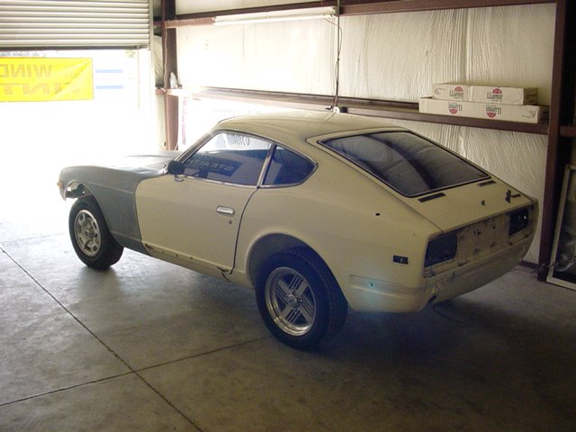

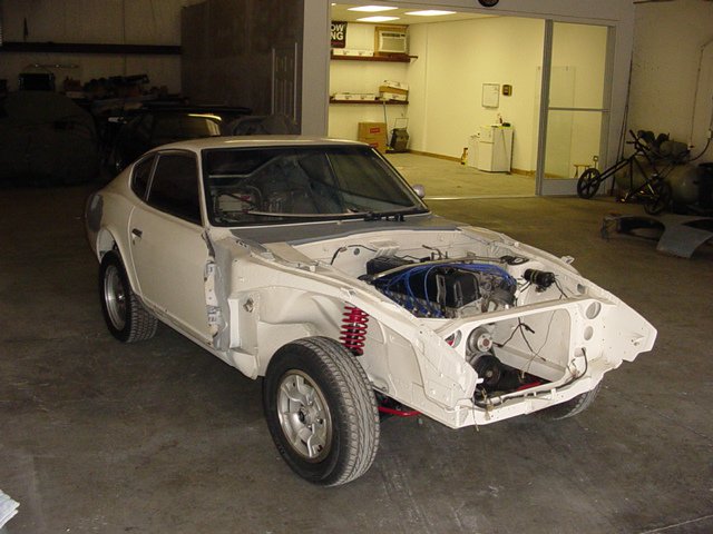

Actually the car [body] was very light when completely stripped . 2 people could move it around the shop with no problem . When we hung the z we had it sitting on a set of 20 inch tires off my tundra , 2 people pumped up the hoists and i held the car at the bottom middle of the drivers side rocker so when it left the tires it didnt swing into the hoists. We grabbed it in the back at the rear bumper bolt holes and at the front corner where the core support and top rail meet . Like i sais the car stripped down is surprisingly light . -

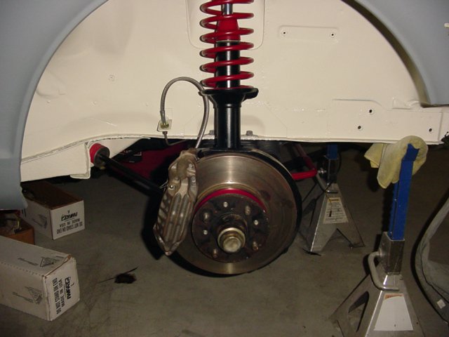

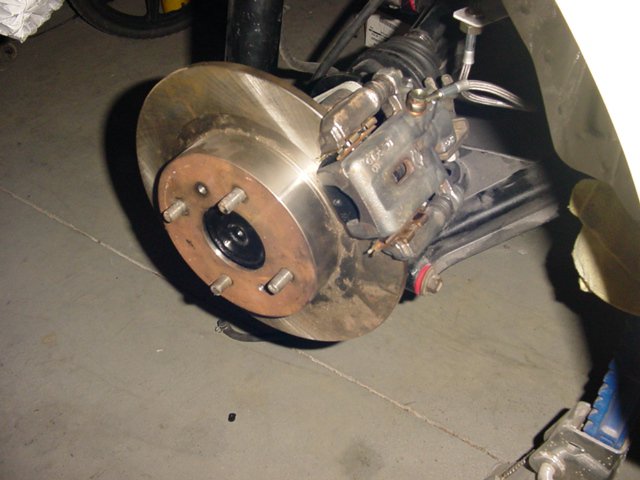

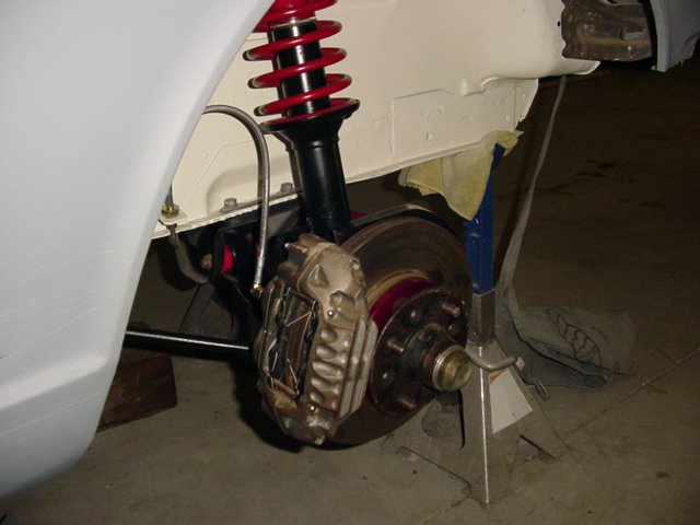

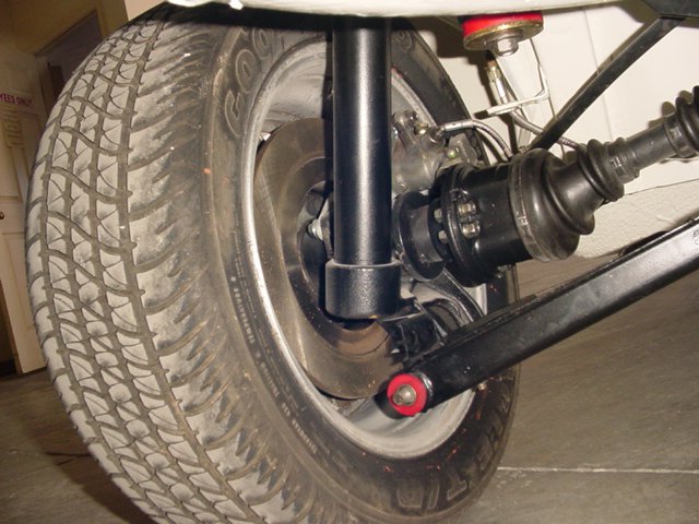

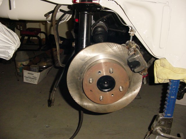

Heres the brakes brembo rotors toyota 4 piston front calipers 240sx rear calipers modern motorsports rear brackets KVR performance pads G stop stainless brakelines -

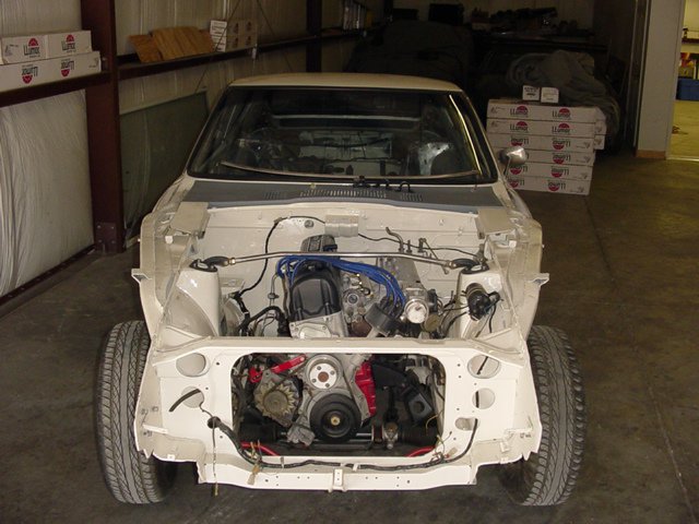

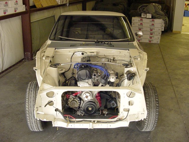

Driveline is in. Got pictures coming up Bigbrake kit as well trying to figure out which wheels rota,s sportmax ?????? -

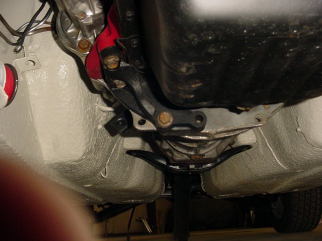

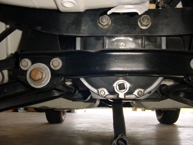

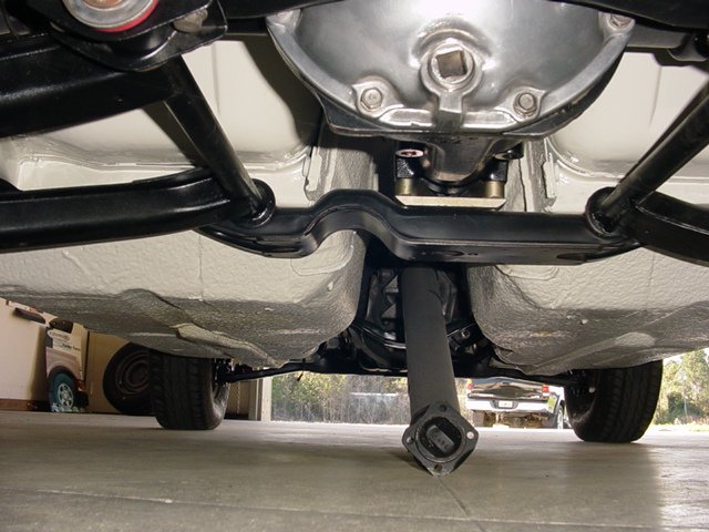

	OK here we go ! I decided to go with the r200 cv conversion on my 71 240z im using an 81 zxt r200 with cv axles out of a 82 zxt. I have the pete style flanges 77 z mustache bar and the 280z rear diff crossmembers ft and rear. So its all in but its tight!! It does not spin smoothly at all . I have read the pete style flange set up and it does say that the z is narrower than the zx and they are close to bottoming out but shouldnt they spin soothly???? If you have any imfo on this set up, your thoughts will be appreciated thanks Greg
