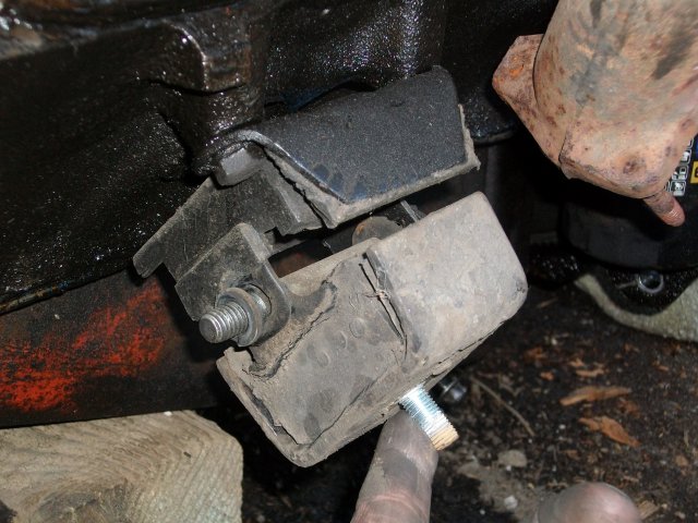

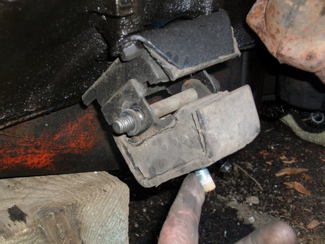

Here is a pic of the mounts , ever seen these before ? I have seen the engine half before but never seen the chassis half

Pics of the mounts I pulled out ? you must mean the jtr mounts , I have the diagrams in the book , if I can get ahold of my wifes camera I will take pics

f I dont come up with some cash or find someone who will trade for them I will probably make them , I pulled the 240 allmost completely apart and the motor mounts that were on it were made of two rubber blocks [each side] one rubber block to the engine and one rubber block to the frame with a bolt pinning them together , not sure what type they are but they mount in the scarab/hooker/nordskog position I installed the rear disks from the 240 onto the 280 today and I am trying to figure out if there is a residual pressure valve I should remove , and if I should change the proportioning valve for a adjustable one
