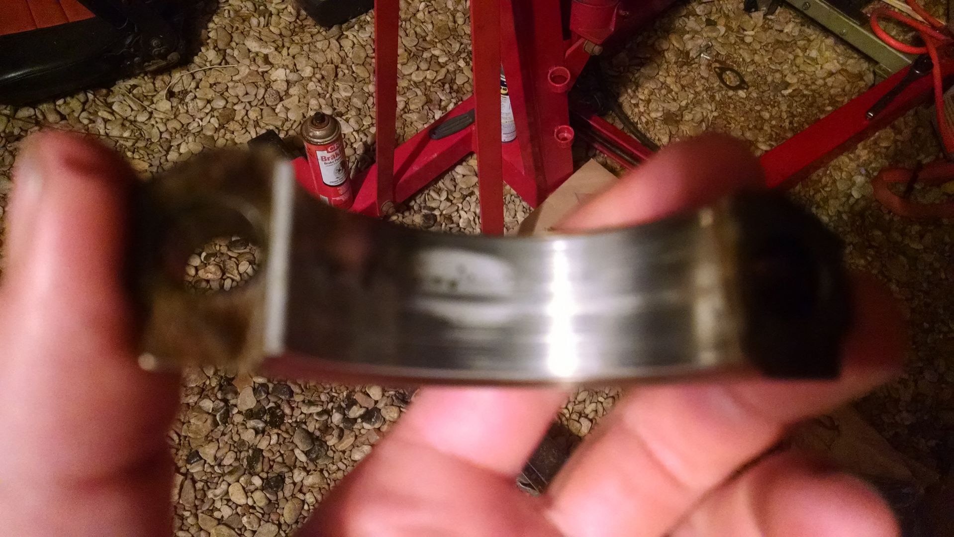

		Was hoping to get the Datsun back together this week. Ran into a possible issue. I checked the rod bearings on this engine "not many miles at all on it" and the milky white of the bearing is worn to the metal underneath. Is this normal wear? I can't feel any wear even with my finger nail on the crank. Looks like it may be a high or low spot on the bearing. Other than that, look OK.

		NASCAR guys have a LOT of experience and they keep plenty of oil covering the valve springs to keep them cool and lasting till the end of the race. Their number ONE problem is valve spring life. I went to a Dart SHP block because it has priority oiling system. Also found a racing oil pan that holds 8 quarts of oil, has six trap doors, two kickouts, decel baffle and a crank oil scraper. Will look into restrictors for the two lifter oil galleries to limit oil to upper end. Would be nice to have plenty of oil in the valve covers with a slow supply and slower leakdown to keep the oil up there to cool the valve springs. Also have a pressurized oil reservoir and a way of logging oil pressure to make certain there is adequate oil pressure in the Hi-G turns. The lesser the amount of Gs in turns, the quicker you get through the turns.
		And rsicard, it's OK, I just don't think you understood what I was after, I should have been more clear. I was guessing that what was wanted was easy clearance to remove the oil pan. Thought that the reason for removing the oil pan was to check the rod and main bearings. If that is the reason, then the crank should be checked for damage. If none, then mike the crank and order new main and rod bearings. Suggested the Cleavite coated bearings as these will take the momentary loss of oil pressure. Be sure to get the fat felpro "O" ring for the oil pickup so no pickup oil leak. Had also suggested going to baffled oil pan with kickouts. More oil volume, baffles to control slosh and crank scraper. Might want to replace the oil pump while at it. Just some suggestions.

		So I missed the brake lines and T/Cs. Big deal. Just wonder how long he will live with the oiling problem. If fixed once and for all, don't need to keep removing the oil pan. Add oil pressure data recording to see if the problem is taken care of the first time in the Hi-G maneuvers.
