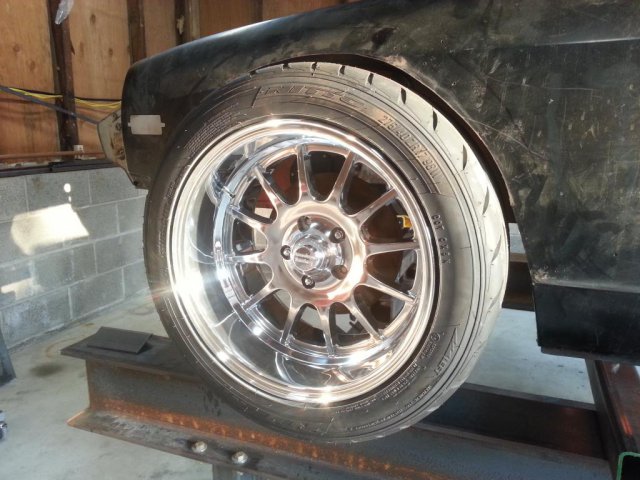

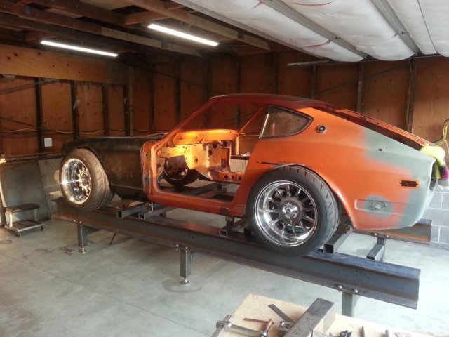

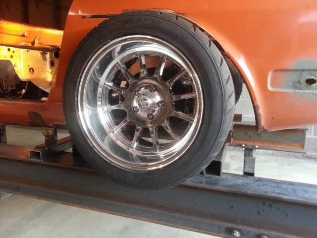

I built an adjustable fixture to hold the 240SX subframe at ride height. Tires are Nitto NT05 275/40 front and 315/35 rear. For wheels I went with a set of the American Racing VN477 with reverse barrels and custom offset. 17 x 9.5 up front and 17 x 11 in the rear. The current plan is to build a set of 911 style flares out of steel and weld them or out of aluminum and rivet them in place. -
I started with a 1973 240z for the body, LS1 & T56 out of a 2002 Camaro, 240sx (S14) front and rear suspension and will be building a tube chassis to tie it all together. Here is the car the day I got it. Relatively rust free and very complete. I decided to build a chassis table out of an I-beam and 3 x 3 square tube. I will also be adding casters to the table at some point. After a substantial amount of cutting on the car I mounted it to the table with some simple pinch weld clamps.

Finally pulled the trigger on these wheels and I couldn't be happier! Front: 17 x 9.5 -13mm offset (reverse barrel) Rear: 17 x 11 -6mm offset (reverse barrel) Tires are Nitto NT05 275/40/17 up front and 315/35/17 in the rear. This car is also getting a full frame with S14 suspension front and rear! -
