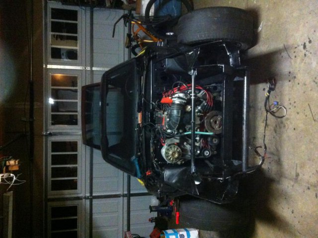

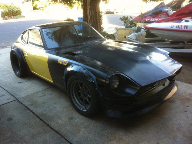

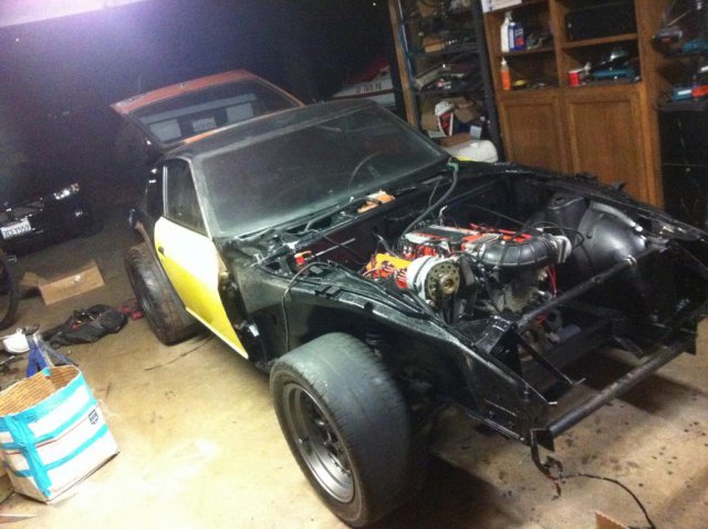

  1. Hey guys, been a while. I been busy with life, trying to make money and been away from home alot for my job. So I am home for serval weeksends. I am trying to put my old Z back together that I been building for years. I want this year of the summer for her to drive! I would need the good ol Z support. My Z is basically a 1973 240Z that been chopped, gutted, and chassis split into many peices, and reworked it back together, rewelded, seamless welded, four inch bottom sectioned chopped. Modifed a 1987 Corvette Rear IRS into the modfied Datsun Chassis. It had a 1994 Police LT-1 with a t

  6. Should the C4 track width be the same in the front of a Z for a auto cross? The stock c4 setup is about 7 inch wider track than in the front of a first gen Z. I think having the c4 wide is good for drag, but alot of understeer. Making it narrow enough the front track is .5 or 1 inch wider than in the track rear. Corvette Rearend is 80lb lighter than the Oem Datsun Rearend. I think it a great upgrade, less unsprung weight.
  7. Try getting the wheels on first then flares, I think your may stick out 5 to 7 inches. I used to have 16x8 with 4 inch offset with 10 inch slicks, they stick out past the fender about 3/8".
