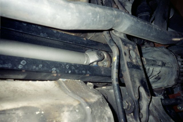

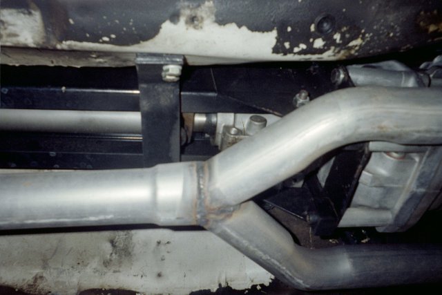

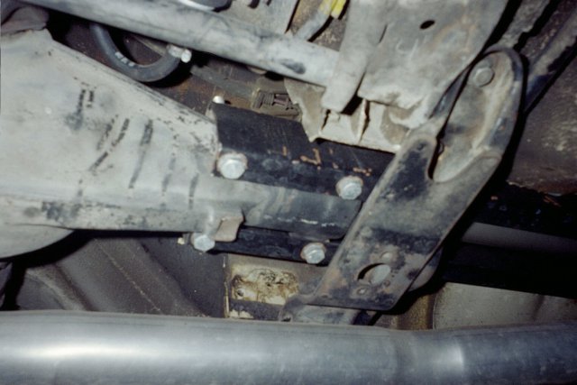

I was going through some old drawing folders and came across these photos of the torque tube set-up. They could be more detailed but this is what I have at this point.

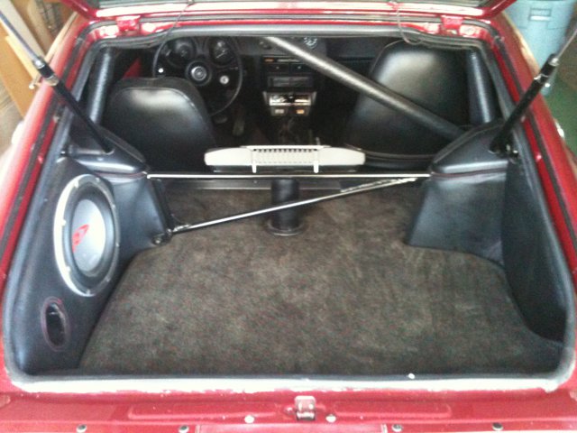

Here is a view of the back deck area of th4e car. You can see the rear strut tower brace, the Alpine 10" ported subwoofer in a custom enclosure and the Alpine 500 watt amplifier. Looking hard you can see the Alpine head unit. The system has a 1000 microfarad capacitor under the deck behind the drivers seat, a 6 disc CDE changer behind the drivers seat, a pair of 5" round speakers in the stock side panel locations right behind the seats plus there are 6" speakers in each door with 1" tweeters on the A pillars.

RebekahsZ - Let me know what you're looking for picture wise. I've posted quite a few here on this site but can take them of specific areas of interest. As far as the motor mounts go - it's been 8 years since I worked with John to develop the kit. The only thing I remember was the issue with the driver's side to ensure the mount would allow passage of the steering shaft. Not everything done on my car made it into the kit, however. The best example is that mine has a torque tup setup that locks the transmission to the differentialusing a pair of 4 or 5" channel rather than using the rear transmission mount found in the kit.
