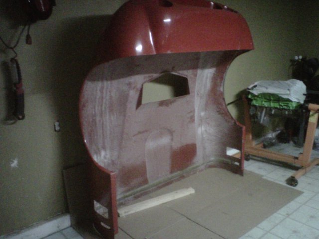

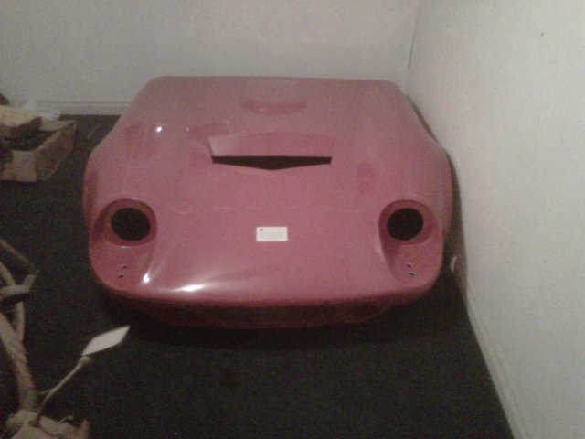

Made a bit of progress on the car this weekend. Now I'm pooped!! For starters, I was able to get the car on some harbor freight dolly's and pushed onto the driveway. Once I had the car on the driveway I was able to remove the body off the of the frame. And put it on the side of the house for storage. What a pain in the ass! I can't express to you how horrified I was removing this thing. Have to stretch the front outward the start lifting up, trying not to snag on anything, meanwhile you're hearing all the creeks / cracks / snaps from the fiber glass body. There was even a spot I noticed on the Gel coat that had cracked. Should be okay, since it will all be sanded down before painting anyways. Well here are some pics of that nightmare: So after body removal, its time to start installing some parts onto the frame, first I started with the control arms, Spindles, Hubs, shocks / springs, and steering rack. The hardest part about all this is going through the box's and bags trying to find the correct nuts / bolts for the part you're putting on the car, and the directions aren't exactly clear about which box you go into to get said bolt. Oh well... I guess its all part of the fun. http://home.tiora.net/davidc/Factory%20Five/Daytona%20Coupe/Suspension%20%26%20Steering/DSCN2942.JPG

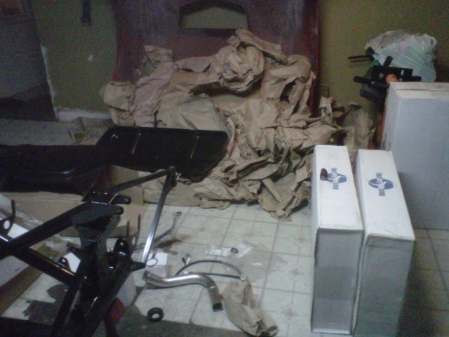

Okay okay, The wait is over! So yesterday about 4pm I get a call from the driver, "Hey man, are you excited yet??" Hell ya I'm excited! "Cool, cuz I'm about 4 miles from your house." So 10 minutes later my buddies and I are all standing in the drive way, and here is what turns the corner! So of course I'm pooping my pants at this point, Its finally here!!! So once we get the car off the truck, its placed on a dolly and rolled into the garage, and placed on 4 jack stands. Along with the car, I've also got a windshield glass, hatch glass, 2 door, and 23 boxes full of goodies. Once the driver leaves, I don't hesitate to start opening them up and doing inventory. There is a HUGE check list of each box and its contents, down to every nut / bolt / washer. So I start going one by one and checking stuff off the list. On Friday my wheels came in and before the day was over, I mounted my tires up. Tires are a 315-35-17 in the rear, and 255-45-17 in the front. So even after staying up until 2am last night going through boxes and checking stuff off the list, I've still got a few more to go. This has got to be the coolest thing I have ever had delivered to my house!!! See, I told you it wasn't a cobra. Its the Type65 Coupe.
my garage went from empty, to a frame, 2 sections of body, 2 doors, racing seats, and 23 box's of early Christmas opening fun!!! I think I'm going to pull an all nighter. Getoff - I love you too.
