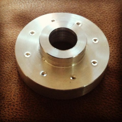

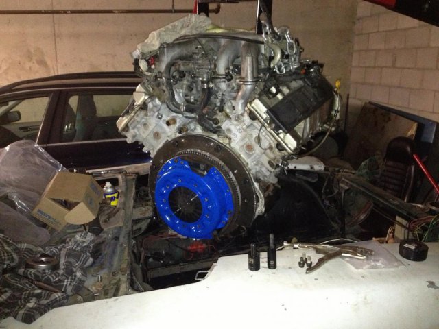

Ha ha, well this "skinny guy" was able to manage because he's still got a brain and a BMW as a pusher. The incline I had to get it up would have been too much even for a big dude. I machined a spacer for the flywheel yesterday - it took me 5 hours! Pictures to come...
