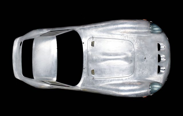

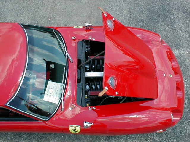

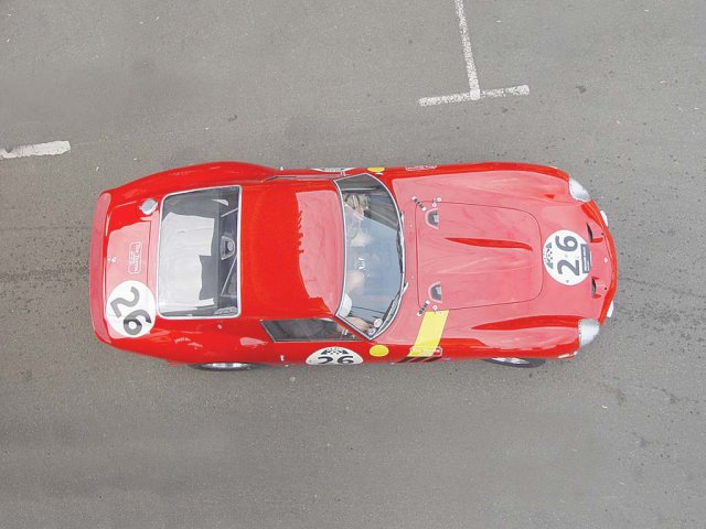

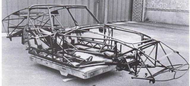

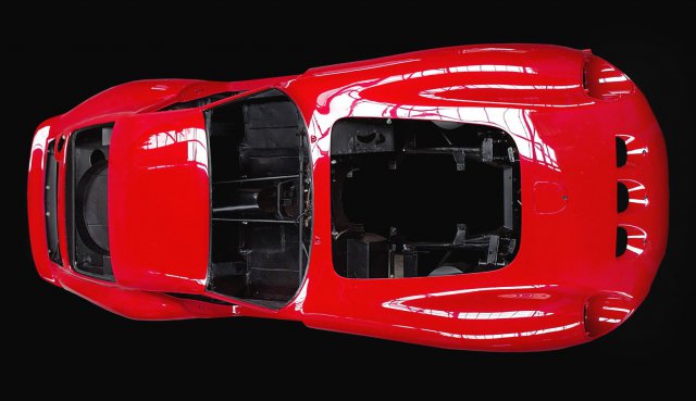

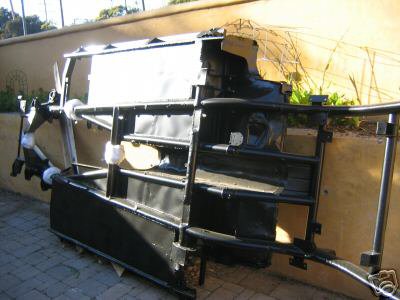

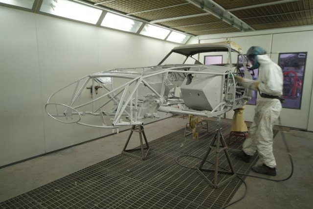

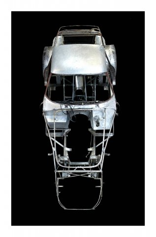

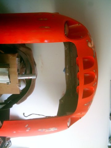

The pic of the Alpha nose leaning against the wall reminded me of the difference i mentioned in the nose. Our headlight buckets are longer than the original GTO's as our noses (on all the fiberglass GTO replicas) are flatter across the front. For comparasin here's overhead view of an Alpha1 nose, the nose on our red car, an original GTO and an original GTO in bare metal being restored an same with paint Hopefully me hitting you with so many pics is useful to you an others an not seen by the mods as me being a bandwidth hog
