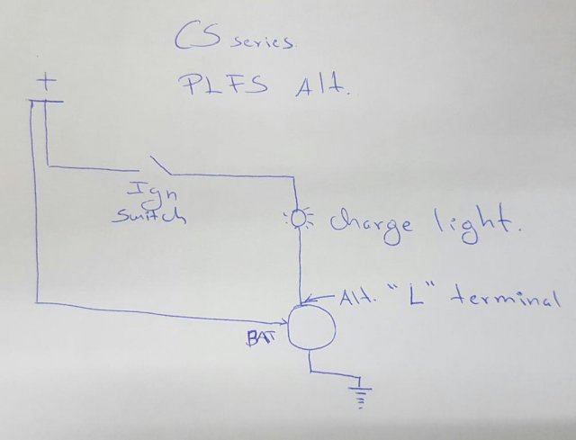

Hi guys, I'm about to finish my Lt1 swap on a 75'z, I'm using a CS PLFS type alternator, I connected it to the L terminal going trough the charge light (like in the picture), but when I turned the switch to on the charge light went on and out at almost the same time, then never turn on again and the Alt is not charging... Could be that the resistance of the charging light is too low and needs another resistor? Do you think I burned the regulator or something else? Thank you.
