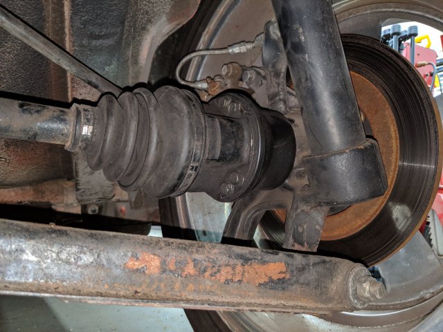

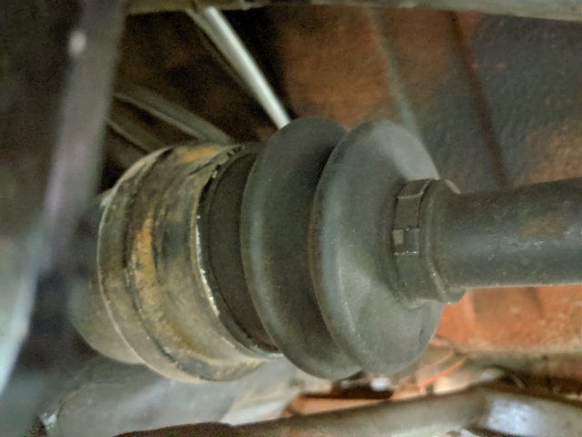

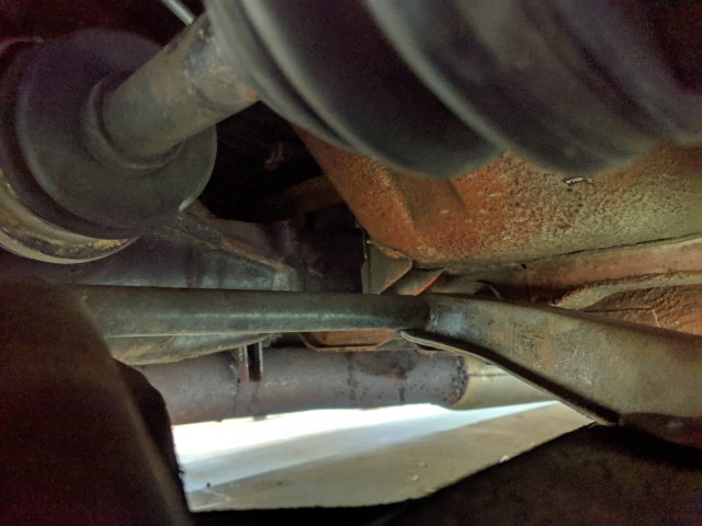

	Hi All A long time back I used Modern Motorsports adaptors & 5 lug hubs to connect via CV joint half shafts ( I think 280zx turbo ?) to a R200 with quaife LSD, it works beautifully! However I want to put a rear sway bar on and the car, it is lowered a lot so even though my 73 comes with stock tack welded mounts for a sway bar, I belive I need a rear mounted one to clear the A arms. Armed with that knowledge I bought the ST sway bar that fits behind the diff and a TechnoToy replacement for the hanger with ears that are pre drilled to mount it. Imagine my reaction as I find that what I assumed would be a simple bolt in mod, was going to be not that simple, the ST rear bar fouls the boot at the wheel end, I need to solve the half shaft problem another way, I do love the CV joint set up I have a stock LT1 + T56 from 1995 so it is just under 300 hp I think. I am wondering if I just revert to normal 280z? half shafts, the problem is that I have been out of this for a long time and I am no longer sure what I have todo to revert this although it has been nice just to use the car and not think. I have the 4 bolt flange that has the big nut to the stub axle from the original car still, I can get 280z half shafts online I think, is that the only part I need ? Perhaps as I see the community is well served with aftermarket parts these days, there is something better ? I took some poor photos of the current set up if that helps, and some guidance would help as I start cutting and pasting information from the web to resolve the the half shaft problem, oh and perhaps there will be a very nice half shaft based solution for sale, assuming you dont want a sway bar PS. yes it is filthy under there and again it is in need of paint but it does get used round town in the summer.

				1973 240 uses a 260/280 rear Sway bar
theBrit replied to theBrit's topic in Brakes, Wheels, Suspension and Chassis
blueovalz It mounts to the floor against the square left right frame, and looks to me like the new mount point ends up next to the stock one, but the bar is not long enough to pick up the stock points. I was hoping some one with a 260 who has one might have pictures. 260DET I dont have a lot of experience setting something like this up. I had a classic mini way back, and that thing was like a go cart, it had a similar set of changes but there was no tire disparity. and no sway bars, it was fantastic, although a little prone to lifting an inside wheel on roundabouts (traffic circles) If I were to change the front, would I use a smaller sway bar ? Could I use a softer rear spring and keep the front as it is ? the front feels like its just right over NJs lumpy roads, the rear a little harsh but not unbearable. Thanks for your thoughts. Mike -
	I currently have a common issue, with a common hybrid v8 set up, trying to get the power down without to much push. The quick question is does anyone here have a 73 240z with a stock location 260/280 rear bar fitted. The 73 appears to have the same factory mointing points as the later cars, or is the only option to drill holes to fit a rear bar to a 240? Now the details and history. LT1 V8, 2600 lbs Front lowered 185lb 2.5" front springs, using MR2 totiko adjustable struts and 1" sway bar, 245x17 tires Rear lowered 225 2.5" rear springs with front 240 totiko adjustable strut V8, quaiffe LSD, 275x17 tires I feel like the car pushes a little, and out of the options I have read about to dial a little of the push out I thought I would try a light rear sway bar to even up both ends. My car is a 73 which has sway bar attachment points that appear to match those found on 260 and 280 cars. They look like the ones in the Haynes and Chilton manuals that show a rear bar. I was just taking with MSA because I ordered their bars and expected them to fit the factory brackets I have at the rear, which they dont. Talking with them all their 240 bars require drilling holes to fit, and they think 260 and 280 bars will not work. I did some googling and found that others have a 260 bar fitted, but I'd like to get my facts straight before either 1. getting 260 bars and looking for my self 2. drilling holes Thanks Mike
