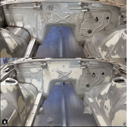

Engine bay/roll bar done in PPG GM black. Outer body is just sanded slick sand, still got some shine to her though even before primer
Dry ice and vapor honing. We got a great local business here who does a hell of a job with that stuff.
Metal work is pretty much done, bad dog frame rails are welded in as well just don't have photos of them at the moment.

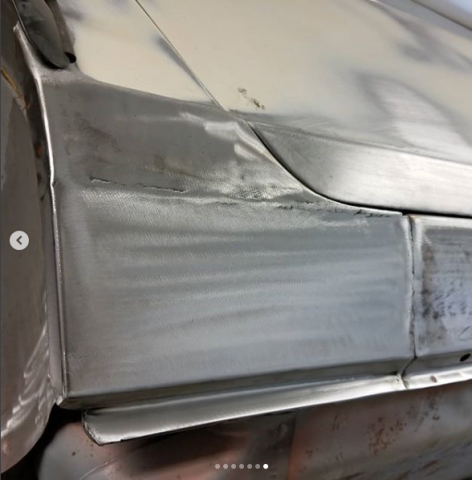

Fenders moved up and snip snip EDIT: Added photo of the inner edge, didn't want any sharp edges that could wreck a tire or a finger in some bizarre unforeseen incident.

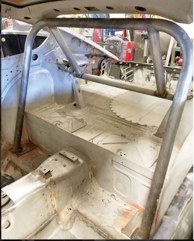

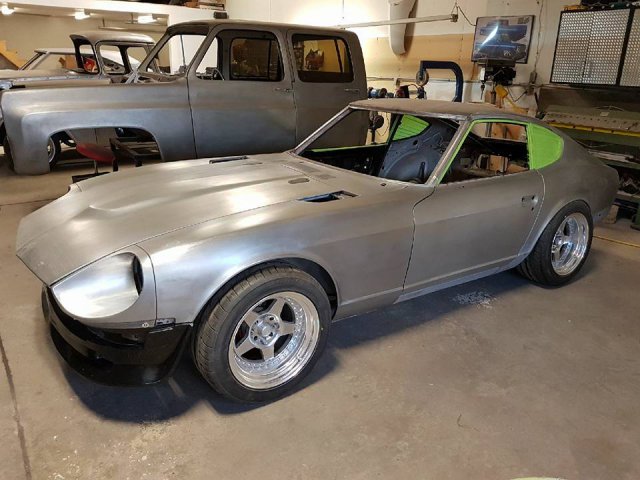

Flares being fit, I think we will move these rear ones up about 1 cm, the tire is going to be out a lot more once the what looks like 6 degrees of negative camber are gone Might run a small spacer to get a bit more flush if need be, but really happy with the fitment altogether. Correcting the body line with the door, looking much more chiselled. Lots more exterior body work getting done soon, I didn't take photos but most of the holes in the engine bay are welded up now too. Simple roll bar, functional, strong, I love some of the full cages people run, they look glorious but realistically I am not going to race this car, it might see an open lapping day here and there so it can be enjoyed properly and stretch its legs.

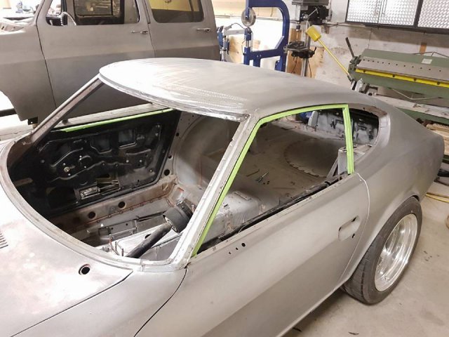

Yeah the metal on the front end of the donor roof was a bit janked. The old roof was perfect, so the two have been merged to prove philosophically that two wrongs can make a right

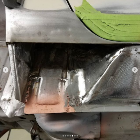

Decided to get rid of the aftermarket sunroof for the cleanest possible look. Removal of factory drip rails was poorly done. Got a fair bit of metal work to do before she goes into primer, but things are finally about to start moving forward more rapidly. Wanted to share a photo of a truck that was painted the same way my car will be. It's why I chose this small shop, guy does excellent paint and body work.

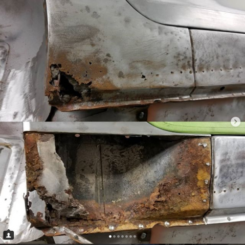

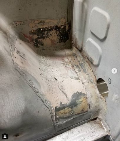

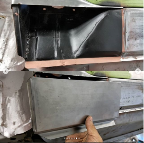

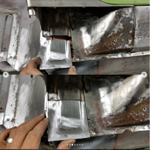

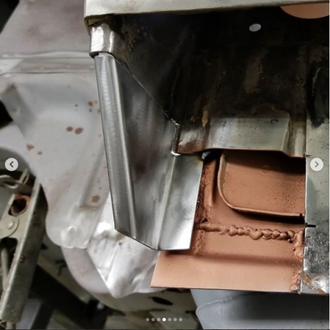

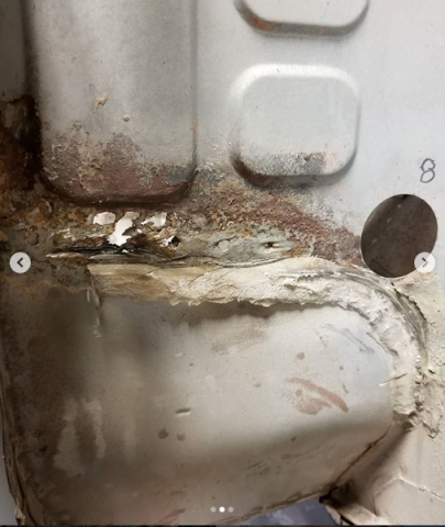

Typical Datsun stuff, hopefully its not too bad to fix behind the battery tray that thing is a nightmare. Hoping I get mounts and headers from McKinney soon so it doesnt hold things up before body primer. Drip rails very disappointing to see what was basically just flat steel welded in before. A whole new 'C' shaped piece will have to be made and welded into place.
