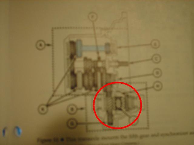

I uploaded a drawing of how a FWD transaxle is like from my text book. As you can see there is a final drive that's like the ring and spider assembly of a differential (circled in red). The only thing I can think of is to replace the gears with similiar sized ones with teet on it so you can hook a chain around them, transfer cases are done that way in big V8 trucks so it should be able to handle all the torque a little 2.0 litre, or less, can ever dish out. Sorry for the blurry photo, my scanner is all packed up so I used my camera instead and I don't have much of a steady hand. I'm 19 but feel 80, lol. -

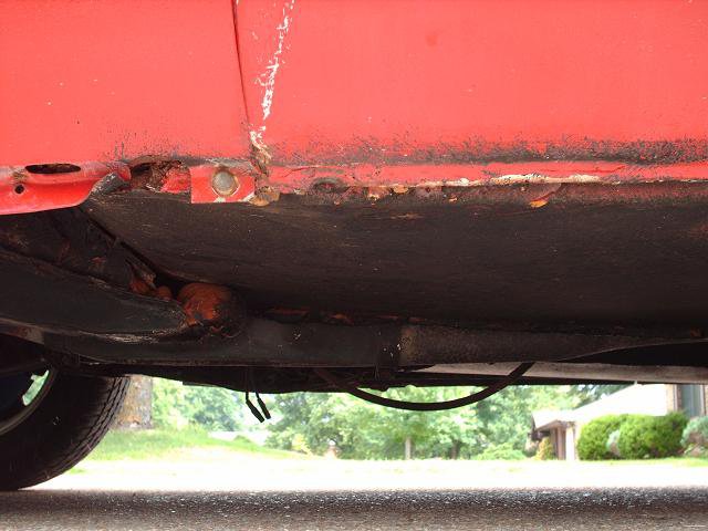

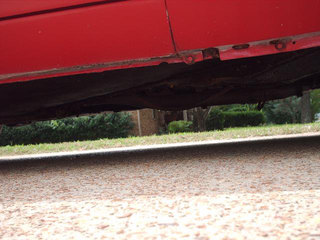

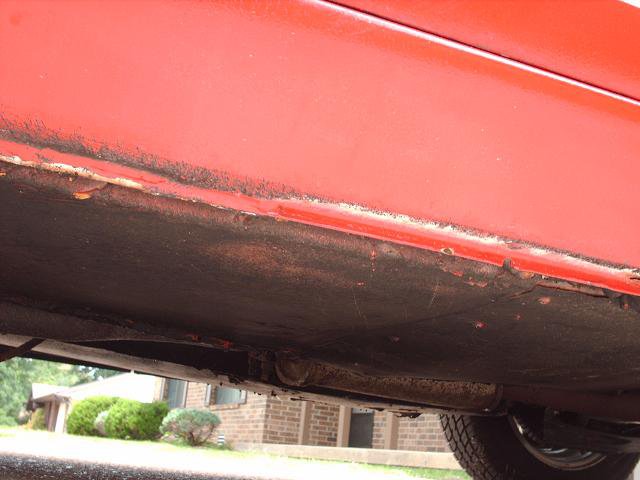

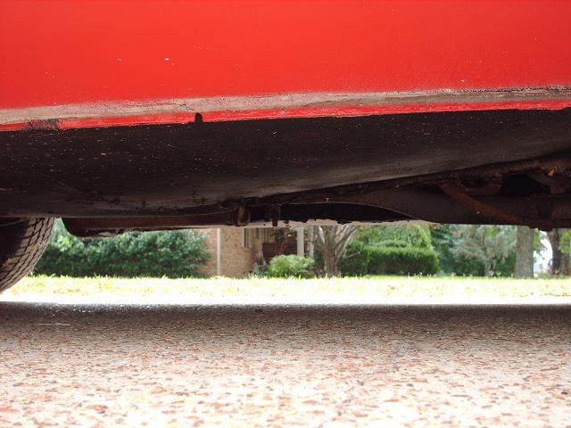

The other side is very similar but has structial foam seeping out of it. I couldn't get pics of the whole thing because I suck with cameras but I got a pic of the front and back of both sides. You can see where the new floor starts in the proper place but goes upward, it also looks like it was screwed together instead of welded.
