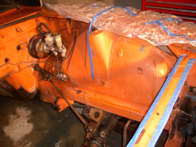

Update; The fronts are cobra 2002 The rears are C4 corvette 1996 I installed a 280Z brake booster. It required drilling new holes in the firewall. It is 8.5" in diameter. I just clears the clutch MC. I drove the car with the same HPS pads. It is a beast. Stops right NOW. Good feel. It looks like aggressive pads are not required with this booster. That said I understand that aggressive pads would make this setup even better. I cannot emphasize enough how much difference the booster makes. Cheers, Cyrus

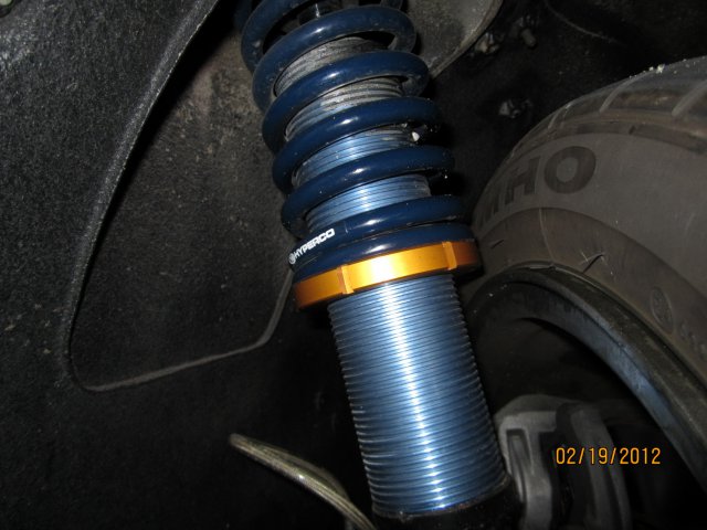

So I dropped the suspension and pulled the strut tube out. The cap looked tight upon disassembly. The bottom of the shock was a little beat. I check the gland nut thread they were good. I checked the tube and found a slightly damaged thread or two. Cleaned the threads and LO AND BEHOLD THE GLAND NUT WENT DOWN ANOTHER ROUND!!! When for a drive, NO KNOCK! Unbelievable. Thanks RebekahsZ you hit the nail on the head.

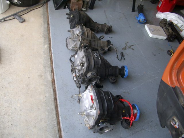

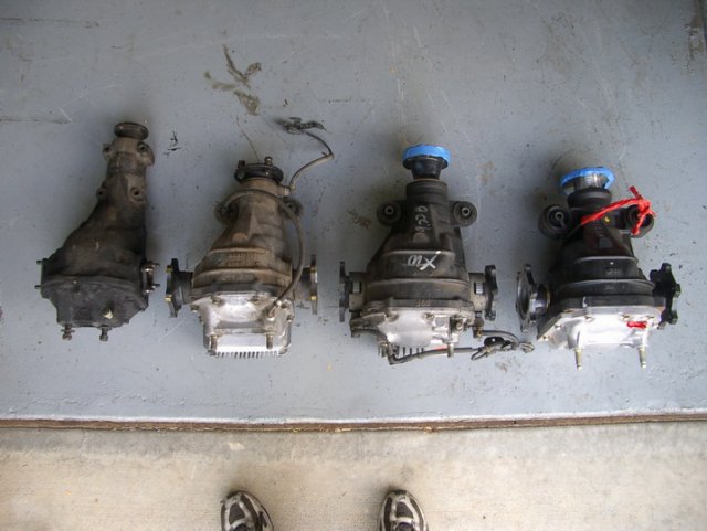

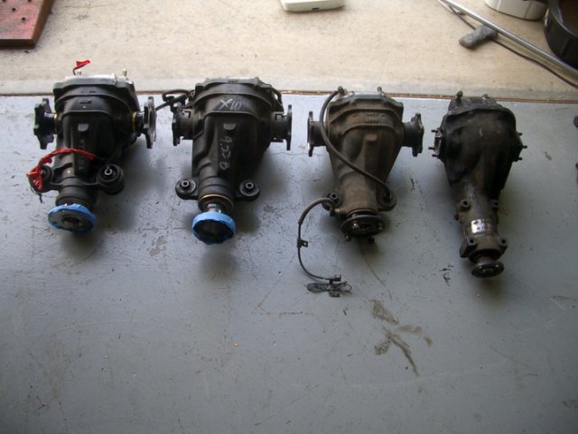

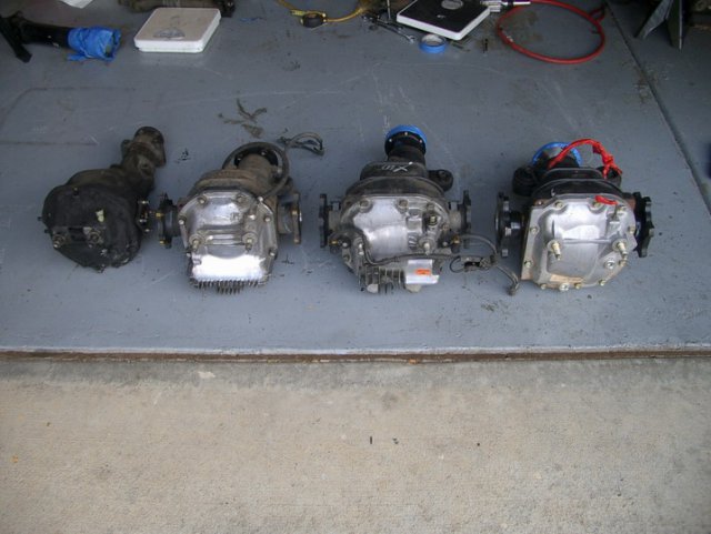

Back by popular demand. R200 (bold in), R200 (Q45), R230TT (LSD), R230 Armada(note flanges are larger) Thanks mrcheese36 for the update.
