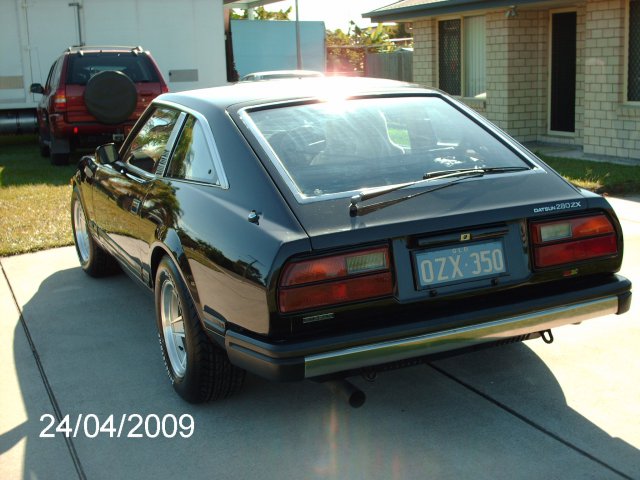

	Firstly finish the garage so you can enjoy the work .I have played with all sorts of cars and my current ride is a 1979 280zx with a 383 chev and 4 speed auto with a 3.7 r200 diff and I can tell you its well worth it to pusue a dream mine was just break the 13 second in a street legal car blew that away didn't I enjoy your car.

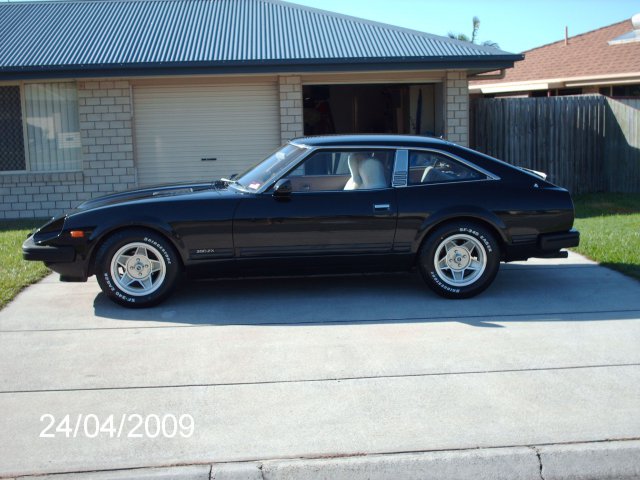

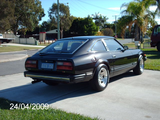

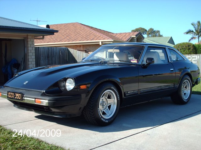

	Here is my old daily driver 79 280zx as you call it a slick top still factory finish with my enhancements 15-8's all round with 235's chev mildly worked 383 4 speed auto the rest as in interior and paint are still original datsun its a real blast to drive what do think of it.

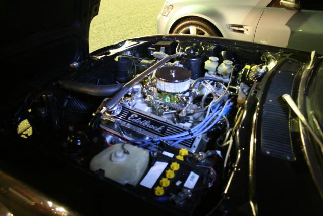

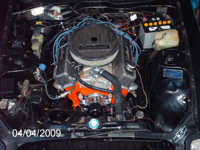

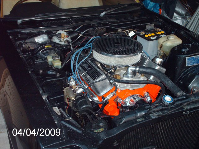

	Hi a few pictures of 79 280zx 350 + 175 nitrous through a turbo 200r4 I have been using it as a daily driver for 6 months now its a lot of fun when it looks stock on the outside. (sorry about the water just washed the engine)

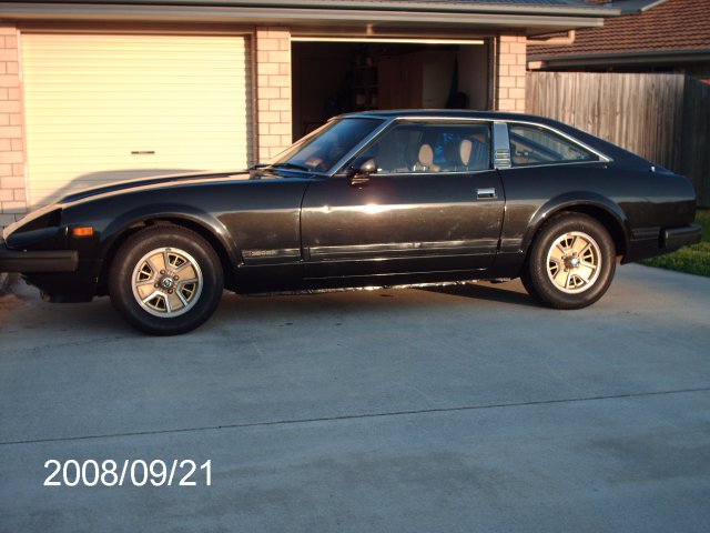

	Stock as a rock 79 280zx 2+2 I have had it a while and its an absolute joy to drive except when its raining it wont go straight http://hybridz5litre z31
