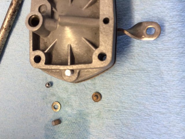

  12. Okay, so I tore down the #1 carburetor and found that the pump body had disintegrated, leaving the check ball floating in the bottom of the float chamber. When I ultra-sonic'd the ass'y, the brass bushings fell apart, so I had to JB weld the small brass peened fitting back in. I didn't however, JB weld the brass bushing seen below. More work! For anyone wondering what the internal pump body ass'y looks like (the small washer is part of the accelerator pump plunger/rod). However/unfortunately, I'm still pretty sure that this wasn't the cause of major hesitation (although it certainly wasn't helping at all. @JMortensen ~ Smaller than 40's on the pump nozzle? Pilots up from 57.5 to 60 ~ I believe the jetting parts list notates that they increase in increments of 5... not sure if that's .5 Cylinder 1 plug = wet... Regarding the Wats being sweet... They are. Trying to not worry about damaging my newly built motor with all of this rich-running carb-tuning. ~C

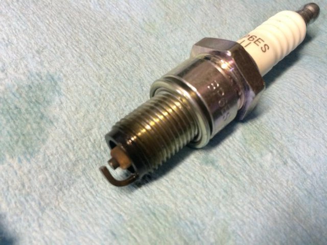

  13. So jumping back in here, I got all of the accel pumps operating as they should. Beautiful streams of fuel out of all throats. But I still nearly drown the motor every time I apply over 15-20% throttle. I emailed back and forth with Todd@Wolf about the issue and I ended up reverting to my 40 pump nozzle and adjusting the cotter-pin to the last hole on the accel pump plunger. No major conclusive feedback. I was beginning to think tonight after putting the project away that I may have fouled my plugs, but my idle is solid and that wouldn't make sense at all. I think I have stop resisting the urge to get an AFR after all of this guessing which is just exhausting. Watanabe's are supposed to be here tomorrow so it's going to be a shame if I can only drive up to 2k RPM in all gears.
