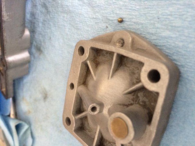

Okay, so I tore down the #1 carburetor and found that the pump body had disintegrated, leaving the check ball floating in the bottom of the float chamber. When I ultra-sonic'd the ass'y, the brass bushings fell apart, so I had to JB weld the small brass peened fitting back in. I didn't however, JB weld the brass bushing seen below. More work! For anyone wondering what the internal pump body ass'y looks like (the small washer is part of the accelerator pump plunger/rod). However/unfortunately, I'm still pretty sure that this wasn't the cause of major hesitation (although it certainly wasn't helping at all. @JMortensen ~ Smaller than 40's on the pump nozzle? Pilots up from 57.5 to 60 ~ I believe the jetting parts list notates that they increase in increments of 5... not sure if that's .5 Cylinder 1 plug = wet... Regarding the Wats being sweet... They are. Trying to not worry about damaging my newly built motor with all of this rich-running carb-tuning. ~C

My additional question to everyone here is: do you have any additional techniques to really free the check ball loose in the pump body? I've been after the two that were seized with carburetor cleaner and a large mallet and have freed them slightly, but in comparison to the one that works well they still 'rattle' less.
